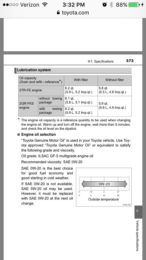

    3.5 V6 hold 6.2 Quarts if memory serves me correctly.

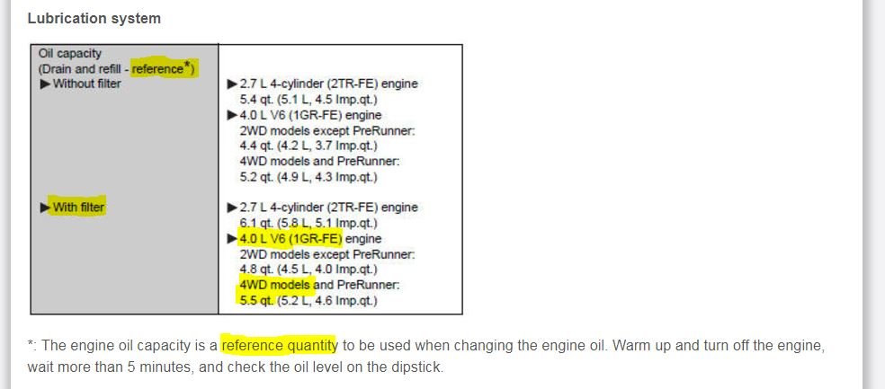

    My manual calls for 5.5, I also did a VIN check (you used truck could have the wrong manual) and 5.5 is correct. If it were 6.2 I would be .7 low, not reading a little over.

    5.5 Quarts was correct for the 4.0 V6 but that engine was in the 2nd Gen.

    Here we go again with TW nonsense. A catalytic converter plugging because too much engine oil? Oh boy. A little bit extra on the dip stick won't hurt you. Also these are a bit harder to read because the oil is so light weight it splashes around and it's hard to read accurately on the dipstick. Also like other users have said it must me level to get an accurate reading. Also best to do it when truck is cool and has been sitting for a few hours if possible. I'll post the factory capicity references below. Remember with and without factory tow package makes a minimal difference

    Here is mine and it takes 5w-30
    I see now that 5.5 is for reference only. As an engineer that says to me that they have more confidence in the dipstick, dipstick tube, and that whole system being more dimensionally correct than the rest of the engine. This is not like the Toyota engineers that I have worked with here in the U.S. or in Japan. I'm guessing lawyers got ahold of the manual and did some editing.
