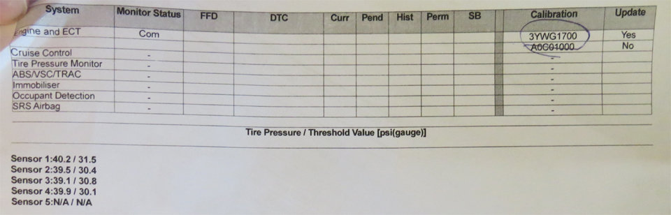

    Hey guys I need to validate the program info before I go to my original dealer with this info. Here is the printout I recieved. My question is the way it is listed on the printout is the 3Y.... software what i'm currenlty running that needs to be updated or is the current software i'm running the A0 ?

    If Toyota put the Ford CrappoBoost into the Tacoma, sales would drop. That Ecoboost is a bunch of garbage. I read articles and forums all the time with about as many complaints with the ecoboost as the driveline vibrations in the Tacoma!
    Gm, Ford, and others also have 3yr/36m warranties. That is the average warranty time for the majority of manufacturers. Kia does blow all out of the water with their 10/10k, but that is not bumper to bumper coverage. If you look at the true 100% bumper to bumper coverages, most everyone is at 3/36k. Some do extend the POWERTRAIN warranty for longer.
    Can't really tell from that printout. However just because it says the 3Y has an update, DOESN'T mean that the 3Y is the wrong software. Updates happen all the time for ECUs. You need to find out what software the 3Y actually is. Then you can determine if they have the wrong software in it.
    Just did a quick check. To date there are a possibility of 9 different calibration updates for your truck, depending on what might be occurring. I don't have access to the actual calibration numbers though.

    I think what happened with your reflash is that they skipped the second upload. A lot of dealers were doing this when the trd sc just came out. See how the first calibration says yes, and the second says no. It's nessicery to do both.
    Personally, I'd ask them for a whole new motor, supercharger unit/fit kit, and ECU (these ECUs can only be flashed once). And you want them to give you a 2year warranty on it all, under their expense.

    See thats what i'm trying to find out, is if the 3YWG Update (YES) - means that I have the 3ywg software currently and it needs to be upgraded to something newer or 3ywg is what needs to be updated from the current software noted underneath, the AOC.
    Or if the 3YWG means thats what the engine software needs to be updated to and the ECT software of AOC is good as it is.

    the update will detune the engine cause toyota had problems with the s/c trucks smoking the trans. im a tech and can tell you the cal id you have is the good one if you update it will not be the same truck and you wont be happy. cause once you flash it your stuck with it and no going back

    I heard about that with the tundra, but that also goes for the tacoma as well?

    yea it the same for the taco. the tundra made way more power with the old flash like almost 500 and new one is like 400ish area
