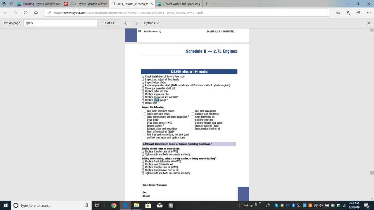

    From the 2014 Tacoma Maint Warranty Schedule Guide - 2.7L - 120K

    Yep - see the post just above yours - #32 - 4 cyl calls for 1st plug change at 120K miles.
