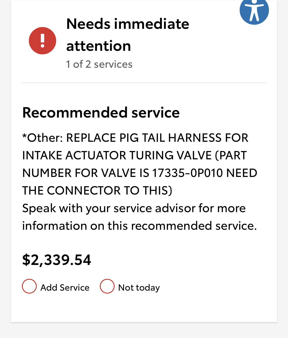

    Took my truck into the dealer to fix a leaky rear axle seal and diagnose a check engine light. They recommended this service as needing immediate attention. Is anybody here familiar with this problem?

    Unfortunately after doing more research it sound like their diagnosis may be correct. If the valve gets stuck open or closed it can cause the symptoms I was experiencing. I noticed a reduced lack of power above 3,000 rpm. Question remains on price, but if I don’t address this it could cause severe damage and be much more expensive.

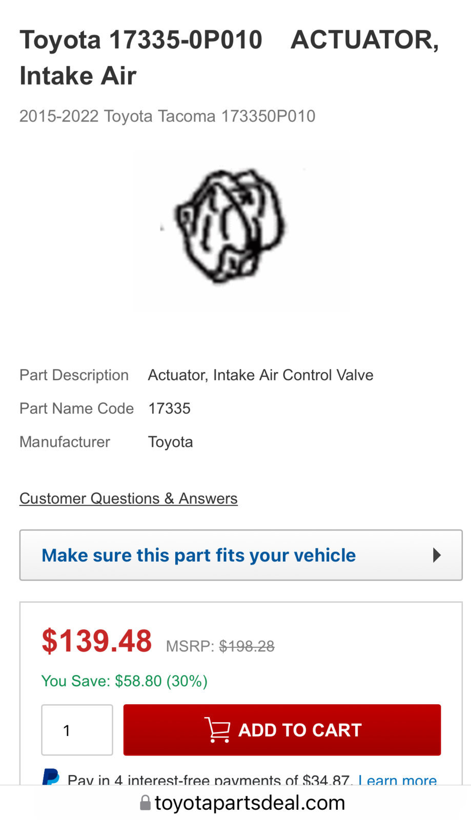

    Ummm this ?

    Yep that’s the part that shows up when in. I look it up. Been on hold with the service department for a half hour. Wondering if something else was damaged for them to quote such a high repair or what labor is involved. Can’t find any information regarding this part failing on other peoples truck.

    Toyota harnesses are comically expensive, its the not the part listed.
    I'd ask why they cant fix it. It's not high current or air bag related.

    So it’s actually harness that they are most likely quoting. What’s does that part do?

    Its the actuator for the valve inside the intake I believe.
    Its odd they dont state what is wrong with the harness. Mice? Corrosion? Damage? what?

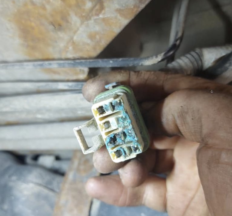

    Water intrusion causes the corrosion that damages harness, its usually called green death. This happens all over the planet.
    It can look like this. Not my pic haha.

    So just got in touch with advisor. He said the harness wires were actually physically pulled out and damaged. Wondering if another shop could have caused the damage.

    So... have the plug repaired/replaced or re-pinned. no need for a harness. Simple electrical repair...
