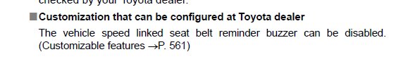

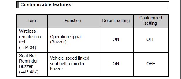

    From the 2014 owners manual

    Interesting. Show the tech the manual.
    It does baffle me why the service manager said okay and he was then turned down.

    My dealership disabled mine with their software. I highlighted in the manual where it said it could be customized. Told them it was a real distraction opening and closing gates as I went through my deer lease and while driving around on the property. No problems. Picked it up and it was disconnected.

    I don't know why more people don't go to Amazon.com and buy a techstream clone and turn off the seatbelt chime themselves. If you have a laptop computer running Windows XP, the cable and software are about $30. Then you also have a very useful tool for when your check engine light pops on.
