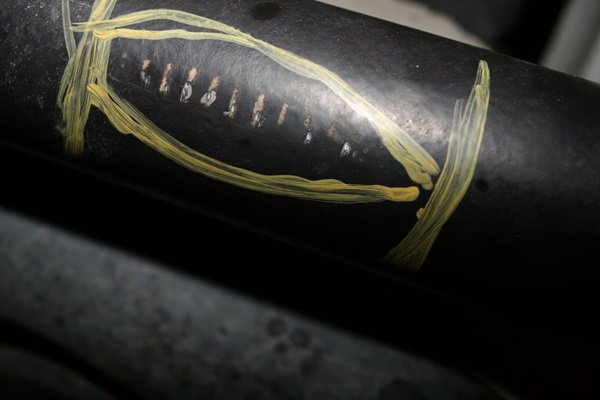

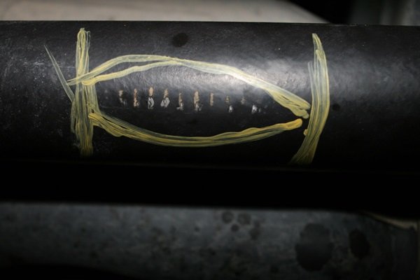

    Now the dealership is saying I hit a large rock or road debris causing an "External Inlfuence" and will not replace the driveshaft even though it has been less than a year since I replaced it. I never hit anything, because i would of see other signs of damage under my truck and there is none, only to the drive shaft. And i just commute on the freeway from home to work and did not encounter a "large rock" as they called it
    Logical reasoning seems to be lacking here because how to these perfect teeth marks get on a drive shaft when it is rotating? seems a lil fishy to me.
    The manager claims he has see it before and has changed hundreds of truck transmission in his 28 years as a shop foreman. Let me mind you guys that this leak all started when I replaced my clutch, and had no problems before.

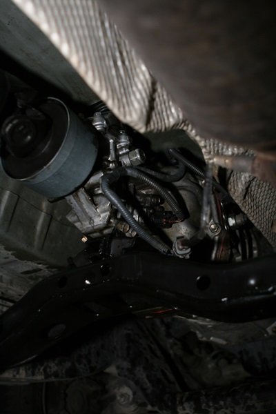

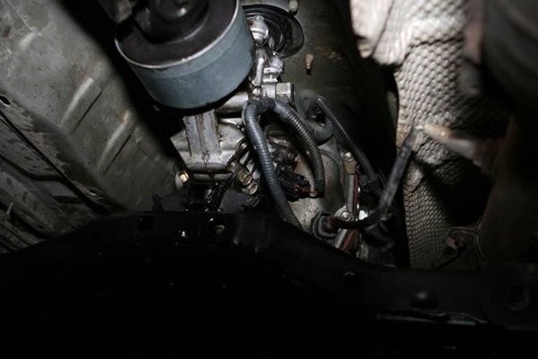

    This is what the leak look likes under my truck
    Just your guys opinion, what do you think the gouges are? I have my suspicions the dealer messed up my shaft when they were fixing something else.

    Did the dealership say you have a transfer case on a Prerunner, or did you mean to type that a bushing was bad in the transmission? A Prerunner doesnt have a transfer case. Regardless, it sucks that you paid for a new driveshaft when you could have replaced ujoints for $20 a piece. Unfortunately the chatter marks are consistent with the driveshaft hitting something while the truck is moving forward, but if it was forceful enough to bend it you probably would have heard it and made a mental note. The ujoint being seized for a long time might have caused the transmission seal to fail and start leaking. Before spending money on a transmission replacement or rebuild, you could take it to another shop and have them replace the seal, and if you still have the old driveshaft, have them replace the ujoints and slap it back on. If the symptoms are still there afterward (hopefully not), then a transmission rebuild/replacement might be needed.

    In order to replace the clutch the drive shaft is pulled and the transmission is also pulled. Either of these steps could involve damage to the rear seal in the transmission. It could also be the source of the marks on the drive shaft.
    The rear seal on the transmission is an easy cheap repair.
