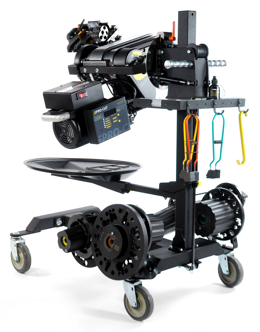

    In terms of resurfacing the rotors, it’s better to do it on the vehicle. That’s why the machines now hook up to the hubs to cut them. It makes up for any variances that may come into play. End results are better then cutting them on a regular lathe, and faster as well. As far as a waste of time, perhaps than replacing with new rotors. However a lot of times if the tech has other work to be done they just let the machine run while they are doing other work only adding a few minutes switching the machine to a different rotor. Saves them time in the process and allows them to do two things at once. Obviously you can just replace rotors and no need to do this service. And in some cases this may be tour only choice or the best. This is just another option and cheaper and better in certain circumstances.
    They normally use a Procut machine that looks like this

    Yep, more than likely what they have. This is what the two previous auto groups I worked for used as well.

    It’s not a sales pitch. The dealer does indeed use a “machine” lol

    Its a sales pitch in a way that their trying to get you to buy a brake job from them cause only "they" have the ability to do it. Anybody can slap on new rotors and get the same thing accomplished sans any fancy brake lathe.

    We cut rotors all the time at work with the on car.
    But first gen tacos we won’t. The rotors have a bad habit or warping if
    You have to make more than 2 passes.
