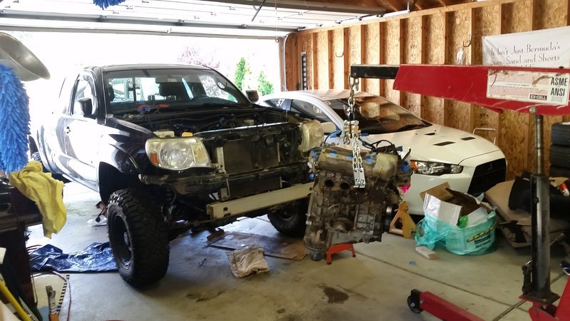

    Fortunately I have 2 mechanic brothers in this state so I will be doing an engine swap myself in the coming weeks (I acquired a 2011 4.0l V6 with 38k miles for $2975).
    Any thoughts on the noise? There is the loud tick but also a lowed tones noise that makes the truck sound like a diesel.

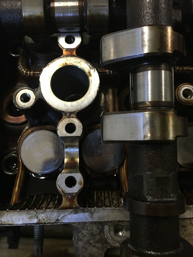

    I finally broke down the engine enough to find the problem.
    The cams were in good condition, as you can see here.

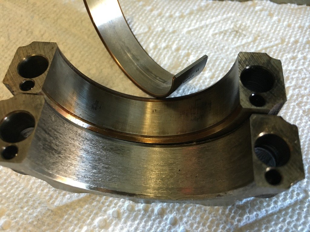

    I broke down the bottom side of the engine and found the upper oil pan to have piles of metal flakes and then I started checking the bearings and found this...
    https://youtu.be/1wLehg-gRo0
    This is the bearing taken apart. The thin piece of metal (the bearing) pictured is supposed to be inside of each bearing housing. The loose one was completely disintegrated. All of the bearing were scuffed up and very rough. You can see how worn down the disintegrated bearing (bottom) is compared next to the better one (top).
    7CA0D9B3-6359-434F-9E7B-058E07176A10_zps_35245d41b228e61ee3b18c61a7641594f763bf8a.jpg
    So moral of the story folks: change your oil! I am sorry to have had to pay for others' poor maintenance. On the plus side, I have a 2007 truck with an engine with only 38k miles and it runs like a dream! Here is a condensed video of the 25ish hours of labor I put into the engine swap.
