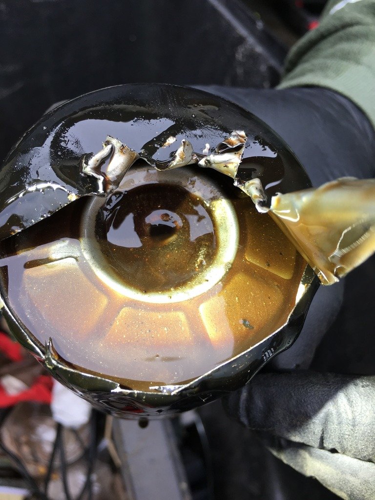

    Just starting to do the swap now. Cut into the oil filter and it was full of metal flakes.

    By the sound I'd would've guessed top end but after looking at the flakes in the filter...... that's rod/main bearing material, most likely a rod bearing
    Don't forget to flush the oil cooler if you have one!
