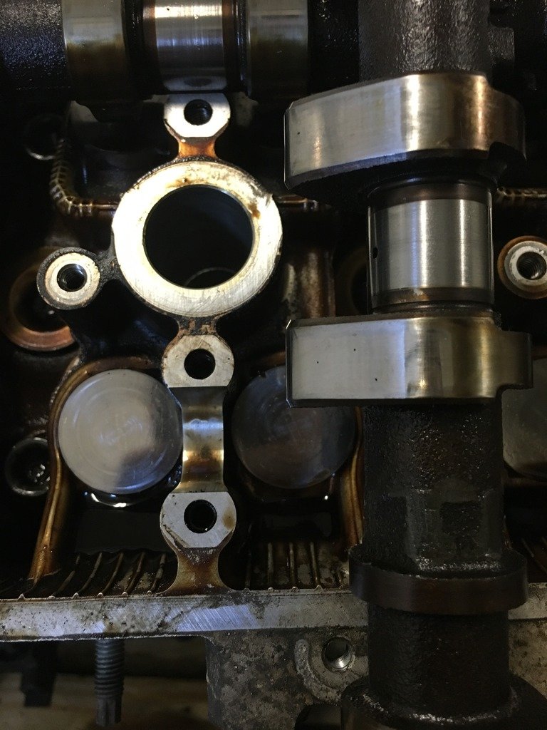

    I finally broke down the engine enough to find the problem.
    The cams were in good condition, as you can see here.
    C1A22DEC-39AD-4328-8AB2-F1958D3E6CAC_zps_992c4e479d173a1d15e88f42faa9b264272e8788.jpg

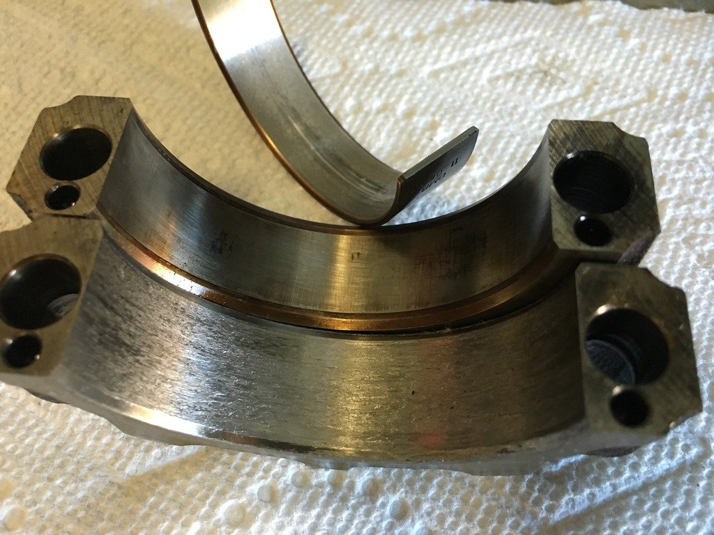

    I broke down the bottom side of the engine and found the upper oil pan to have piles of metal flakes and then I started checking the bearings and found this...
    https://youtu.be/1wLehg-gRo0
    This is the bearing taken apart. The thin piece of metal (the bearing) pictured is supposed to be inside of each bearing housing. The loose one was completely disintegrated. All of the bearing were scuffed up and very rough. You can see how worn down the disintegrated bearing (bottom) is compared next to the better one (top).
    7CA0D9B3-6359-434F-9E7B-058E07176A10_zps_35245d41b228e61ee3b18c61a7641594f763bf8a.jpg
    So moral of the story folks: change your oil! I am sorry to have had to pay for others' poor maintenance. On the plus side, I have a 2007 truck with an engine with only 38k miles and it runs like a dream! Here is a condensed video of the 25ish hours of labor I put into the engine swap.

    Accept for the head gasket failure which caused the bearing failure.
  20. Jul 7, 2016 at 7:36 AM
    #60
    AKdude007
    AKdude007 [OP] The mountains are calling and I must go
    Feb 11, 2016
    #177911
    202
    EAFB
    2007 Tacoma TRD Off-road
    Vision X Light Bars KB Voodoo Bed Rack Tuff Stuff 4x4 RTT
    There wasn't a head gasket failure. The oil was only milky the one time I changed it last year, when I first got the truck. Subsequent oil changes were clean.
    Now that I know what a good engine sounds like, I think that my engine was bad the whole time I had it. It always had a small tick. I chalked it up to being the "Toyota tick" everyone complains about. I compared it to a friend's 4.0l V6 in his 4Runner a few months ago and mine was significantly louder. The bearing just finally gave out after a five hour drive through a couple mountain ranges. It was only a matter of time.
