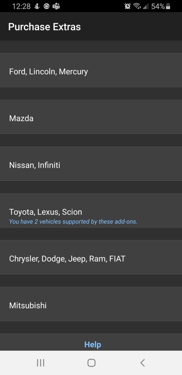

    Get fusion obd2 app and buy Toyota PIDs($16). If use Android, buy Veepeak OBDII mini ($14) and you can see everything..
    Check phone OS compatibility if Apple phone

    @Vlady - Toyota PIDs... Who sells that list?

    It is under fusion app. Purchase Extra
