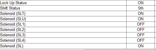

    SLU solenoid that controls TC clutch is active when tranny temp reachs about 110°. TC gets fully locked based on ecu tables for each gear/throttle position/speed.
    We mostly turned TC locking off in 3rd on early tunes. Never ECU calibrations have TC lock in 2nd.

    So, does your tune directly manipulate flex lockup? Or, indirectly by manipulating the the full lock tables?

    In the tune,, we can manipulate when to turn SLU On/Off (one set of tables) and when to fully lock(another set of table).
    Also, there is a dependency on the engine torque.
    Supposedly, there are transmission pressure tables that could be modified.
    Slipping phase of TC commonly exists in lower speed driving.
    At high speeds you want to be locked, otherwise tc temp goes up.
  8. Jan 29, 2023 at 3:56 PM

    I'm trying to understand how you are able to monitor the flex lockup vs based off an ON/OFF only display from SLU. I was under the understanding, flex lockup is accomplished through a PWM signal to the appropriate solenoid feeding the lockup clutch.

    We don't have access to PWM, duty cycles and line pressures at the moment. Supposedly all these are coming
    BTW, toyotas TCU data list doesn't not have line pressure, duty cycle etc.
    So we have to use what we have available and adapt.
