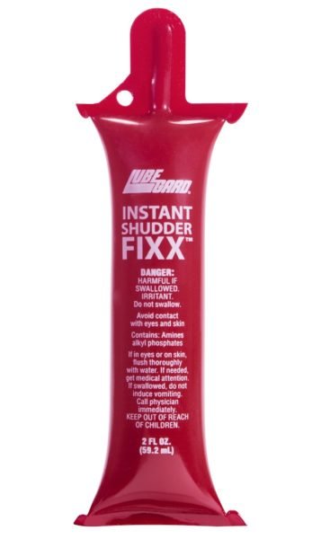

    I'll replace the tranny filter next month and I want to get a device to get the tranny temp and check the level. Also bought some Lubeguard Highly friction modified (ATF) supplement Dr Tranny shudder fix.
    I want to sale the truck to get a work van so I need to fix this. I'll keep you guys posted

    Might end up doing the same thing. I have had the shudder from early on, now at 26k. Is the lubeguard added, cycled through with the new ATF and then the final level check at temp?

    I have also seen people talk about a larger bottle (10 oz) of Lubeguard Platinum. Not totally sure how to add that much fluid.

    https://www.lubegard.com/products/platinum/
    DIRECTIONS FOR USE
    LUBEGARD® Platinum® Automatic Transmission Fluid Protectant can be added to any ATF (except CVT, DCT, and Ford Type F [1986 and earlier models]). For normal applications, add 1 oz. (29.6 mL) of LUBEGARD® Platinum® to 1 qt. (1 L) of ATF for the total capacity of the transmission with motor idling. DO NOT OVERFILL. Always consult your owner’s manual for vehicle specific instructions. To determine fill capacity, use our OM ATF & Conversion Chart
