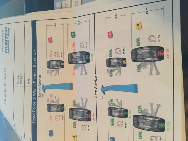

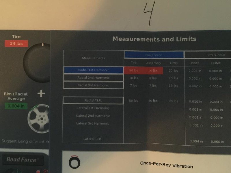

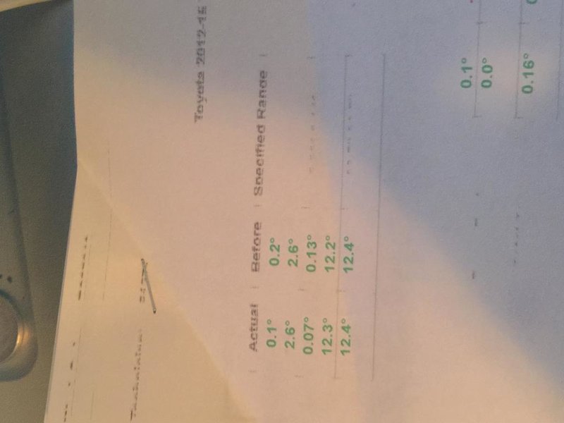

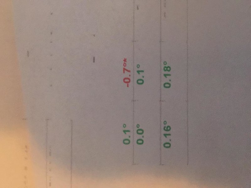

    So I got the truck back after about 4 hours of waiting. The alignment seems a lot better but its tough to tell since traffic was stop and go on the way home. I will know more tomorrow morning on the drive into work. The dealer says there is no damage and everything looks good as far as the front suspension, bearings, etc...
    Now for the weird part. Here are the alignment numbers from today. The dealer said they aligned it yesterday. How was it out of spec after 1 day?
    Also the roadforce balance readout from today. I have 1 tire that is way out of specs. This is really strange since the tires were just done 1500 miles ago and all 4 were just fine. I find their road force printout strange since it looks like the bad tire was originally on the back left.:rolleyes: I wonder if they realize that I marked the rim/tire that was hit? :D I guess I must look stupid.
    I'm about fed up with this now.
