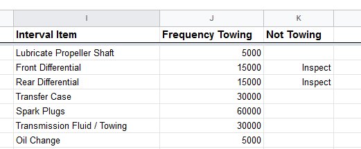

    I'm very persnickety, but I tend to follow the recommendations based on severe conditions (which include towing and city driving). I also try to get on an mixed up schedule. So I can alternate services. Like, I'll do the Rear Diff at the first 15,000 miles, but do the Front Diff at the next Oil Change, so It'll take place at 20,000 miles. That way I don't end up with a $1,000 service, but each service ends up around $150, $200.
    Oh, and those of you with ATs. Seriously, follow the Severe conditions interval. Which I think is 60,000 miles - your transmission will shift like new again.
    So I follow this schedule:
    tonered likes this.
