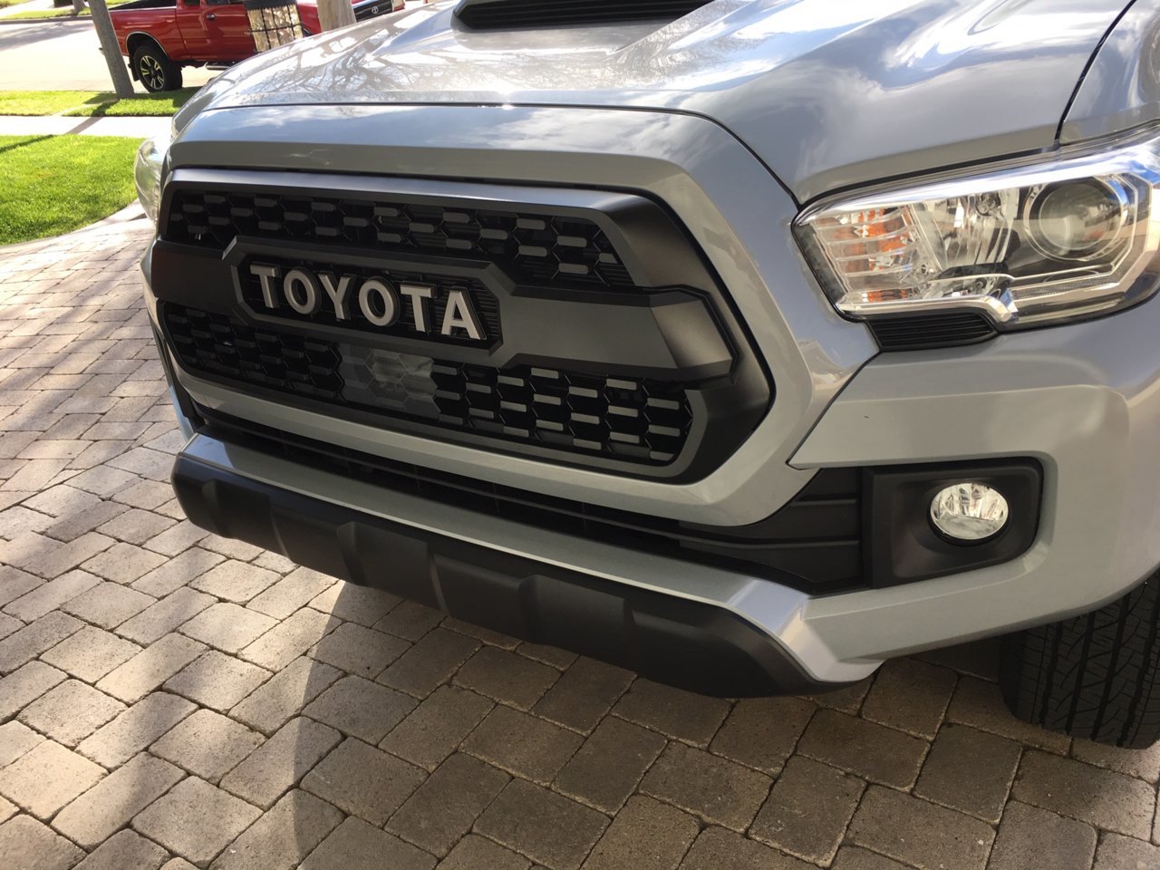

    I just installed mine last night on my TRD Sport, along with the black lower bumper trim to replace the painted piece. Went pretty seamlessly. Kind of a bitch getting all those clips released at the same time but not a big deal.
    The only thing that frustrated me is the push on clips that hold the TSS sensor garnish to the new grille are hard to push in enough to keep the cover tight. You are trying to push the garnish inward while pushing the retainers opposite and getting that last 1/10mm of play eliminated is difficult. Worked at it for an hour, one little tang at a time. I recommend getting two thin o-rings and slipping them over the posts before you try and slide those push on retainers down. That'll allow you to crush the o-rings a little, keeping the cover nice and tight. Should have twist on retainers that can be tightened. All else went fine. Used the longer harness and I like that it stays hidden.
