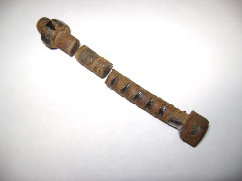

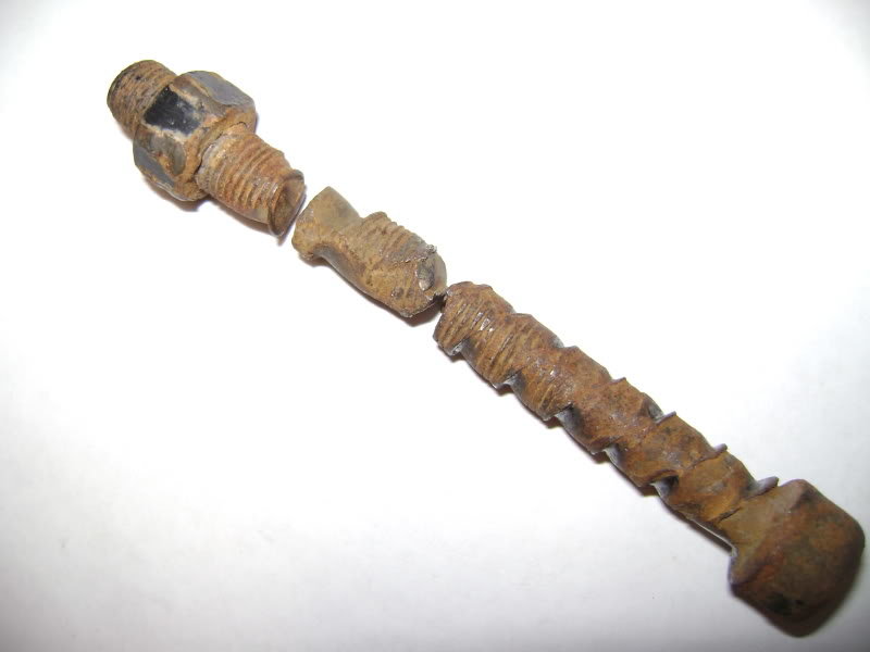

    FYI, if your ubolts are not torqued enough you run the risk of breaking the centering pins from the individual leafs moving around. There are a lot of forces at work.

    I've seen this happen multiple times while offroading....it ain't pretty.
    And if you have blocks - I've seen pieces of broken blocks fly out and hit people standing near the trail. The pumpkin twists upward and the driveshaft & u-joints can rip holes on the underside of your body/rig.
