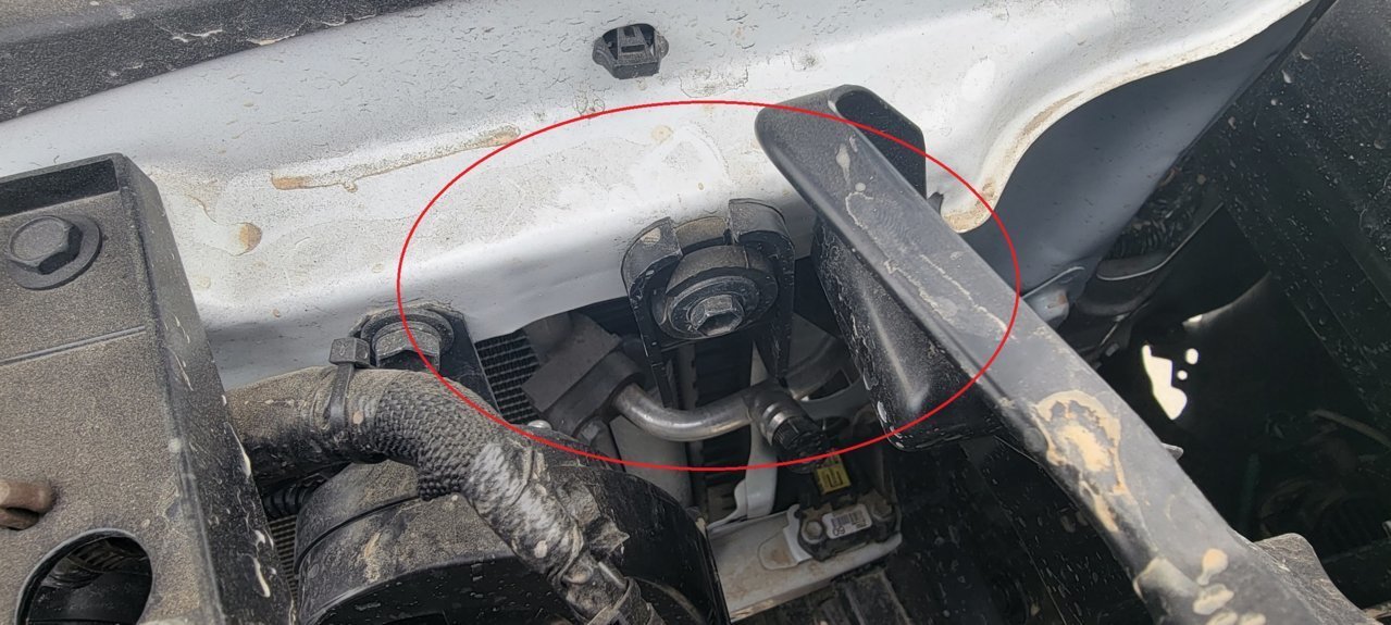

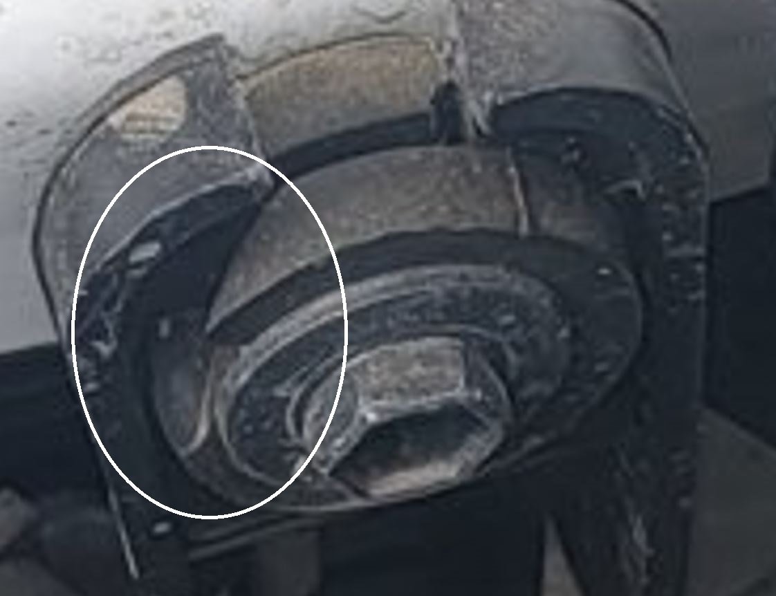

    Took the truck for 12 month and asked to have a bracket on the AC condensor replaced. I say its broken/split and they say its normal. Can anyone confirm?

    Look at the washer diameter... no way it would fit in the seat if the bracket was together at the top.

    Yep thats normal and the way they are made. Nothing wrong there.

    Are you talking about this broken piece, around the washer/bushing?

    Big deal. That has nothing to do with the condenser.

    Pretty sure thats normal too, thats how they get the rubber isolator into the hole. You tilt it, push in then twist and it goes into the hole.

    Thank you just asking if it's broken or not. It's a $6 part that I will replace myself if it's actually broken
