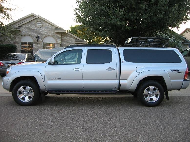

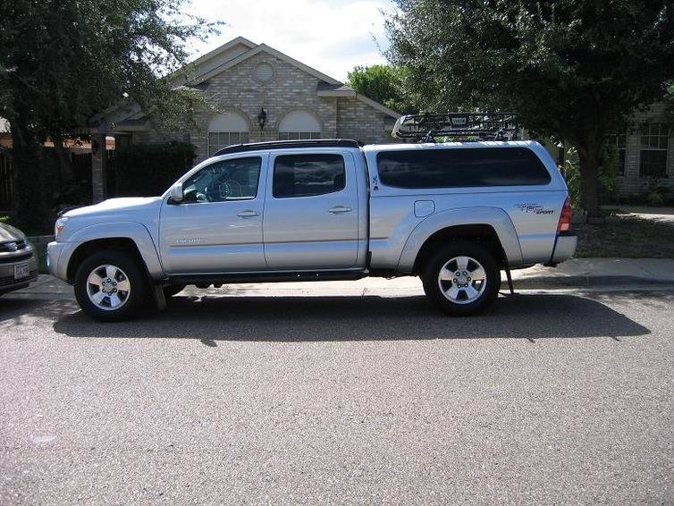

    Toyota of Laredo did it! after two times and a TRD demotion. But request it to anyone over there, they all know by now how to do it correctly.
    Believe me they will do it!
    BEFORE:
    AFTER:
