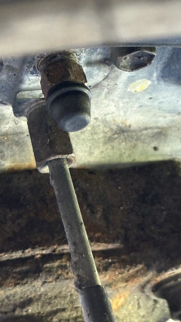

    Can you give pics of your bleeder valves? I want to see if they hacked them up, or used the correct tool, or if they are rusted beyond recognition.

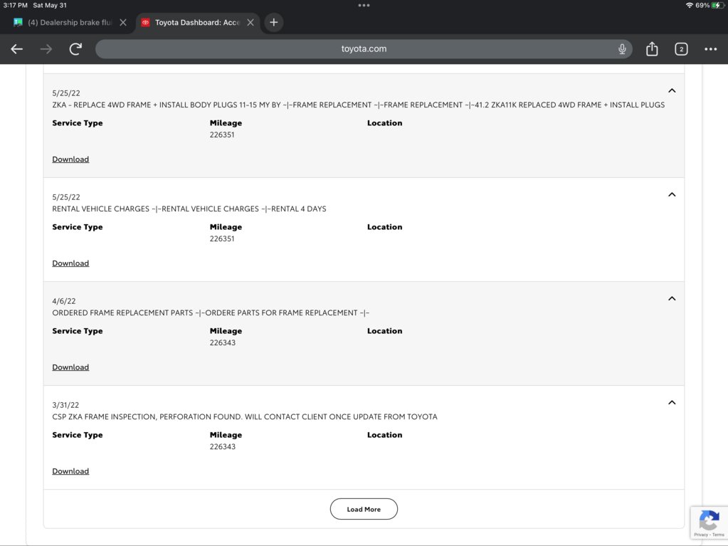

    Flip keys, changing as much back to OEM (lights, bumper, panels, chassis), and buying all the missing pieces taken from the dealer before selling me this truck.
    The truck is a 2011 with 255389. The place I bought it from is another story… the owner was refused a new frame and caved in to trade it in. Then the dealer approved the new frame when it was in their inventory. They also charged Toyota for a rental… when I reported it something must have happened because they wound up changing ownership.

    Nice work on the PI effort. That all seems, well, less than up-front. Gives me the creepy feeling of previous owner getting bullied into buying a new truck, and dealer profiting higher on his trade-in. Okay so now we know what you are dealing with, not sure if you can get a fair shake out of this stealership to correctly, fix, what they have effed-up on your 4x4 service, without getting more money out of you to fix what they broke. Jeez, your tools are somewhere else... If it were me, I would not go back to that dealer, er stealership, for anything. Not even this. I would correctly bleed the brakes to see if that cleared anything up. I would track down each code and see where it points to, cleaning all sensors with a good shot of brake cleaner to ensure their connections and sensor reading-points are free and clear. Let me see what these codes mean...

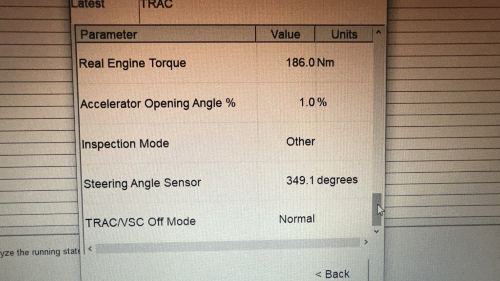

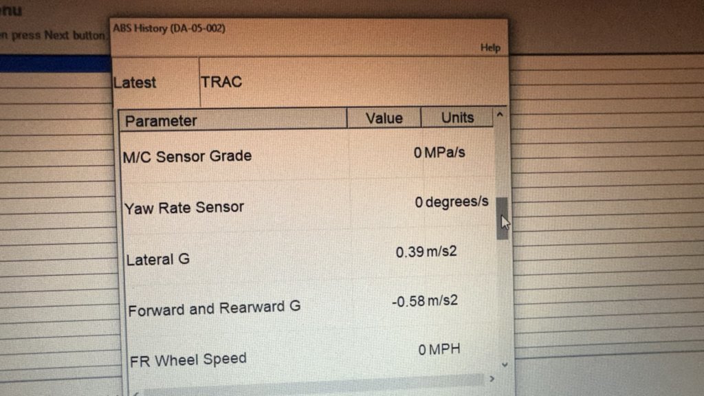

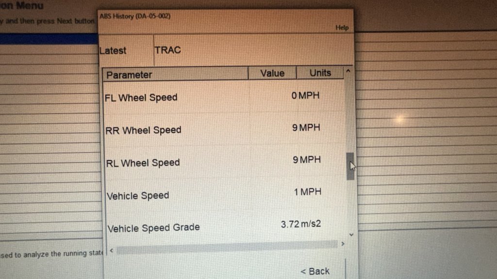

    that’s what I’m worried about. This is from the health check

    I'm not convinced they bled the brakes, I don't see any moisture on the caps, signs that caps were even removed, or any moisture on the valves anywhere. You may have gotten the old brake-fluid top-off treatment.

    Thomasburk. I think you have a good eye! I agree with you. That cap has not been removed.

    But that wouldn't explain the pedal going to floor when he picked it up.
    And he had brake fluid on the inside of the tires
    They opened something..

    From the pic, it didn't look oily to me. Okay maybe they hit it with brake cleaner, I don't know...

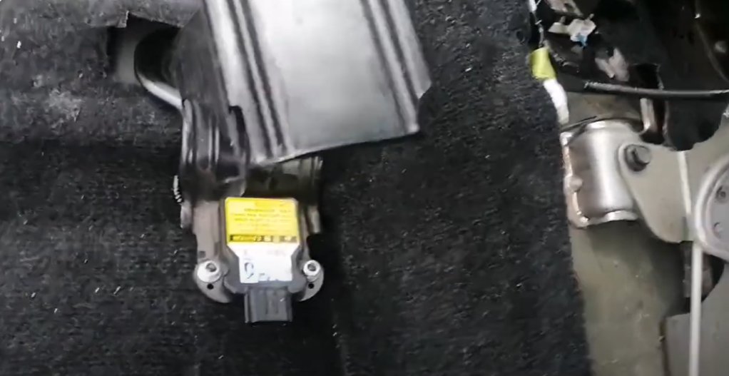

    U0123 code indicates yaw sensor miscommunication, maybe OP shoud check this connection under the seat, could be a simple visual inspection and or possible correction like plug it in.
    Yaw sensor underseat, as such:
