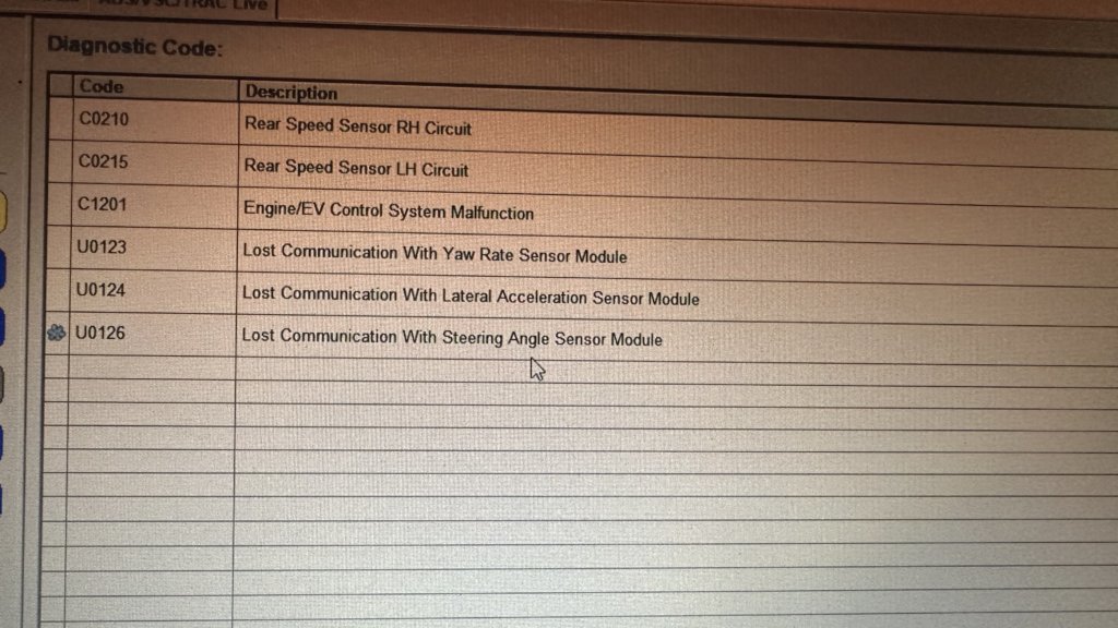

    From the pic, it didn't look oily to me. Okay maybe they hit it with brake cleaner, I don't know...
    2 more observations. If the dirty connector got wet during the brake fluid service, could that fluid/dirt have interferred with the communications and caused the flutter of codes?

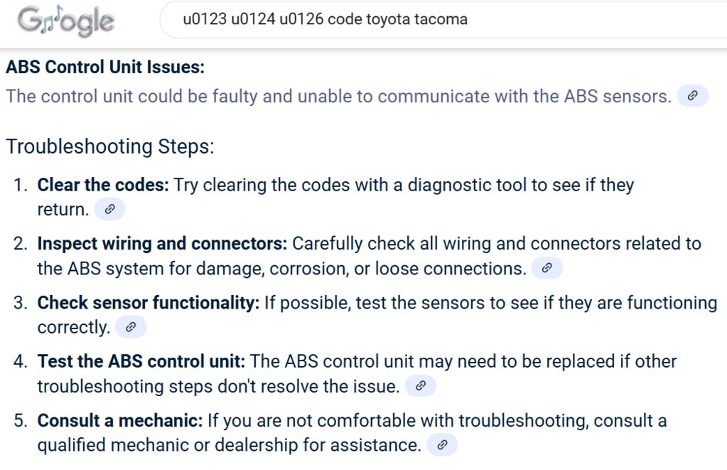

    Trouble shooting suggestions by 'google' is outlined here, for the 3 codes. I would also check fuses under hood, are any blown?

    Thanks! Looking at the battery, they definitely disconnected the negative. The ground wire is bunched up in a weird S shape toward the screw on the truck. I’m looking at the pages on here with the VSC and zero point calibration to cleaning the gas cap and port.

    I PERSONALLY don't see anything weird on the recpt - but MAYBE when they worked on the differential, they bunged up the harness. Correct me if I'm wrong (I haven't looked at mine for awhile), but doesn't the sensor wiring come down to the differential then split to the two sides? Have you tried testing for continuity - first from the wheel to the harness center, then from there to the front? Usually there will be two connections (I haven't looked at my Taco).
    One from the wheel to a central point at the rear, then another one from that point to somewhere near the front (which then goes to the control module).
    If you know someone with a tester like the Waekon ABS tester, it makes it pretty easy. It's a little pricey, but I bought mine when I the ABS system on my wife's Prius was getting wonky. It can not only test the sensor directly (to see if the sensor is generating signal), but can also generate a fake signal itself to see if the signal reaches the module. So you first test the sensor, and if the signal from the sensor checks out, you use the tool to generate a signal. If the module doesn't see the generated signal, you try it from the next connection. If the module then sees it, you know it's a wiring problem between front and back (you can also test to see if the tester can see the signal from the sensor to the front connection). If it STILL doesn't see anything, it could be the module (or the last mile wiring, which would be really rare).

    Not sure if already mentioned. A broken ABS sensor would give you braking problems. My buddy just had this happen to him. He went to brake and had to pump the brakes like 3 times to stop. One local shop wanted to replace the master cylinder and do all these expensive repairs. Took it to another guy who just changed the ABS sensor, problem fixed.

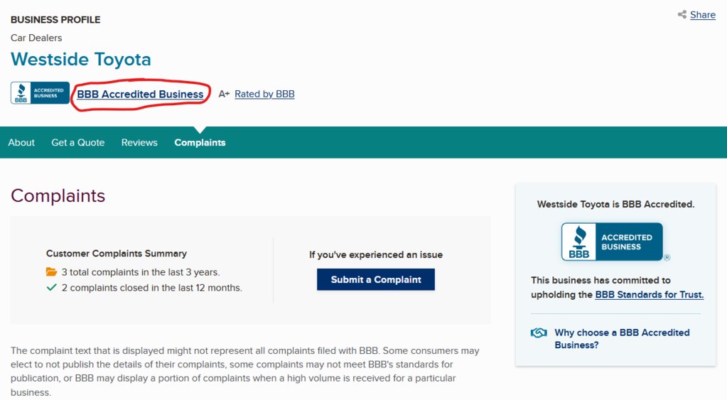

    Out of curiosity, I looked them up on BBB. At least their BBB page (assuming it's the same Westside Toyota) looks pretty good, but I PERSONALLY don't put too much stock in BBB ratings anymore. Note - they are BBB accredited, so maybe complaining through them MIGHT get you somewhere.
