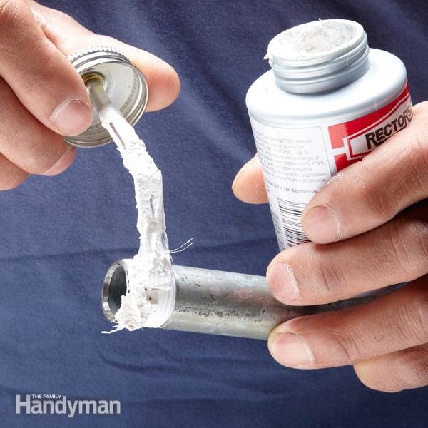

    When I first bought my Tacoma, I removed the pan bolts and applied a good helping of plumbers pipe dope and when I need to remove the pan they always come out easily.

    I wish I knew man, but I bought the truck used I think they were seized at the time of purchase, but its a good heads up for 3rd gens tho, I think I read a couple of posts about problems getting those bolts out already in the 3rd gen forum, they really over torque them from the factory once the rust sets in its all she wrote with them

    To be honest with you, the only reason I used anti-seize on the bolts was from the experience with my previous truck. About a month after having the truck serviced I noticed the pan missing while changing the oil, remembering how difficult the bolts were to remove the last time, so made sure that never happened again.
