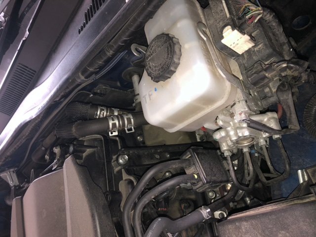

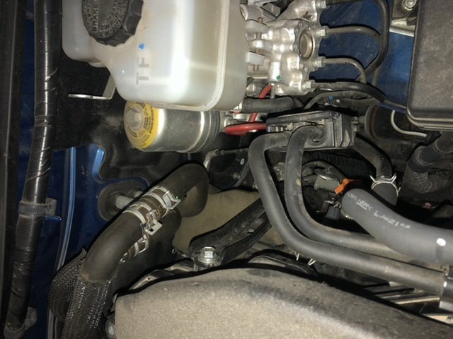

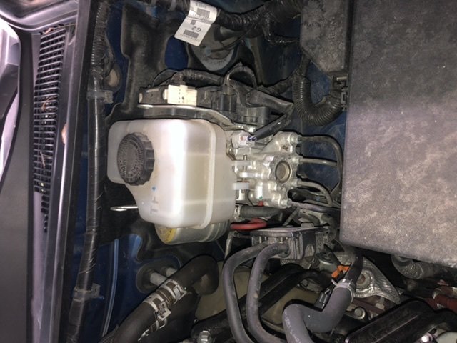

    Easiest way to determine whether or not you have one is to post a picture of what your brake Master Cylinder (where the brake fluid goes) looks like.

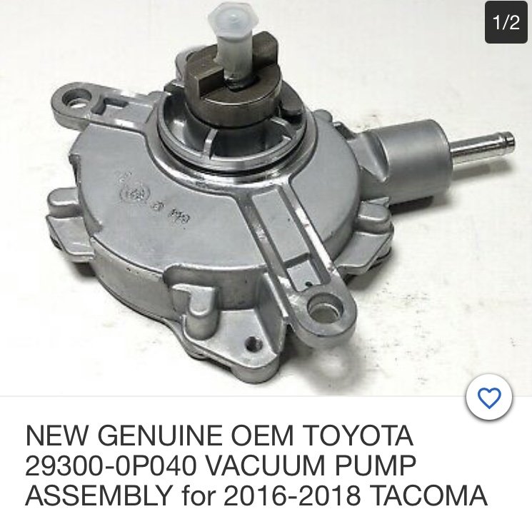

    Yes they have a vacuum pump see photo for clarity

    You have an OR so you have an electro-hydraulic brake booster. The only vacuum pump you have is for the EVAP system located near the fuel tank. That picture @Ronzio posted, you don't have that - it's for the vacuum boosted brake system on all models except an OR and PRO.

    After seeing pics on here, I was able to see the oil leak from above. It is around the power steering pump and it’s tiny.
