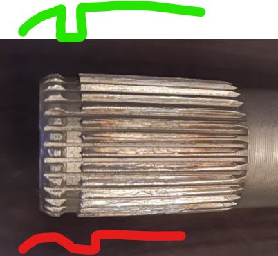

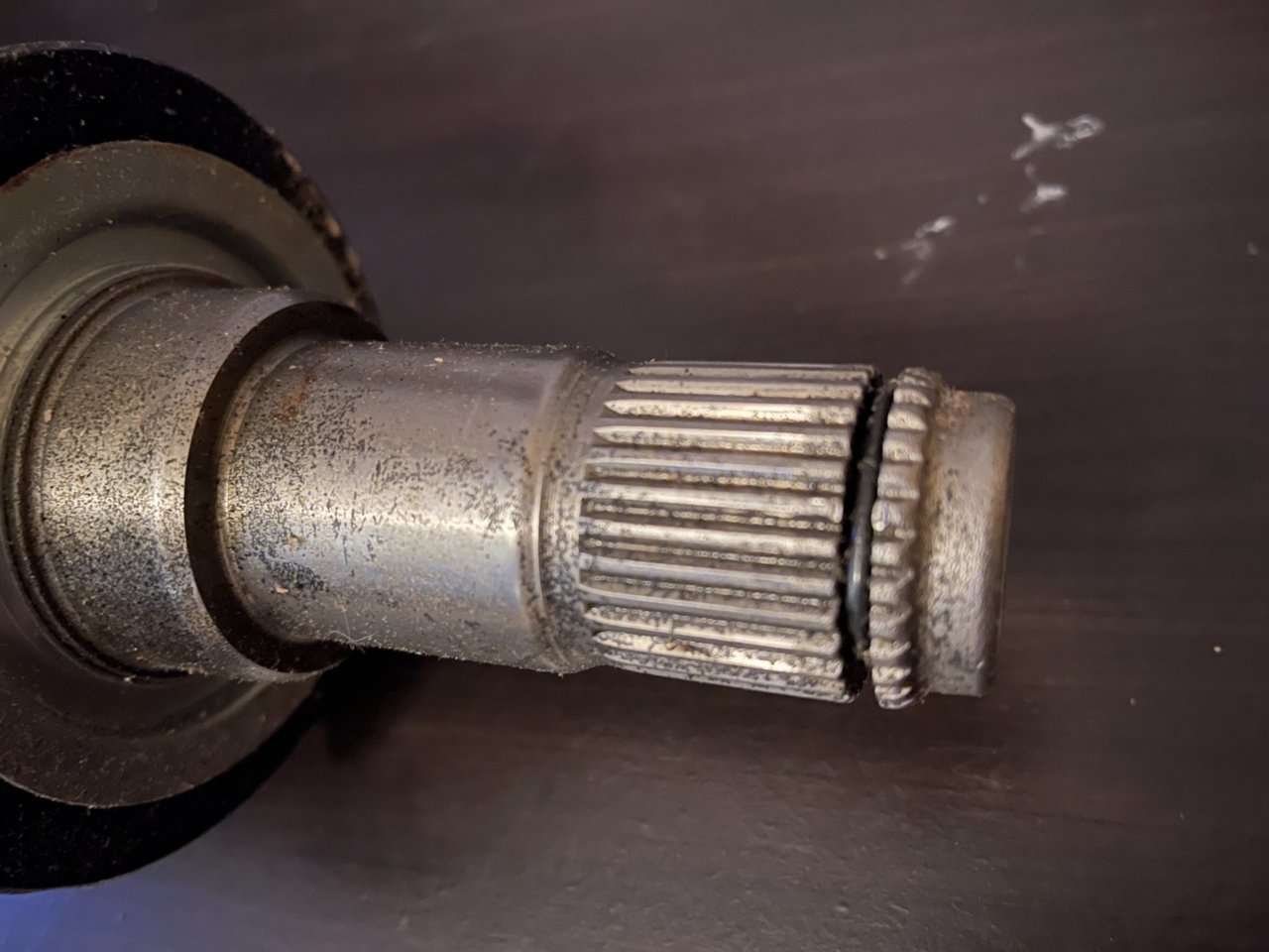

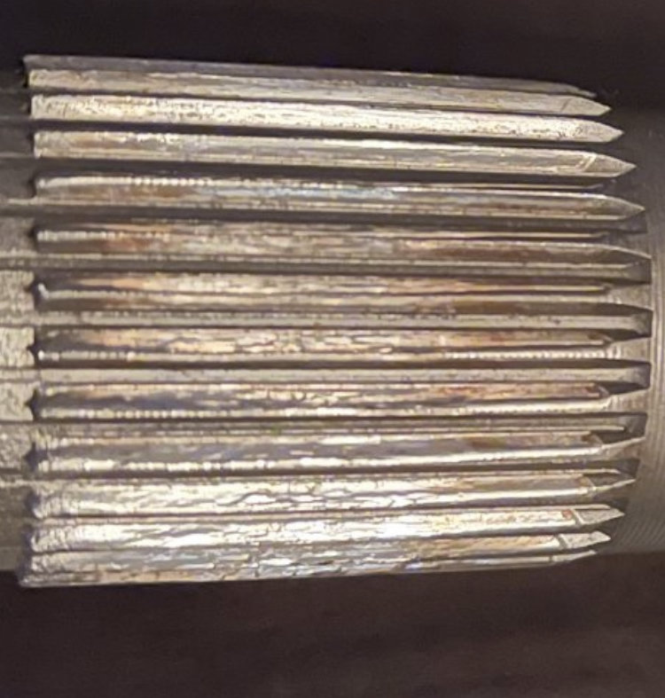

    Not on Land Cruisers. On Ih8mud the Toyota reman cv axles for 100 series have been proven to be crap. They don't touch the inner or outer splines. On a Tacoma that's fine because the outer is held together with an axle nut. For the LC it's terrible because the CV is held in by a c clip, no axle nut. The groove of the c clip has to be in good shape, otherwise the c clip could come off causing a major failure. These are photos of reman Toyota axles.

    I said all wear items, not all worn items. The splines are not considered to be an always-replaced wear item. You're absolutely right though, they should be checking the c-clip and splines more carefully, so that's a bit of a pisser for sure, and unlike what I've typically seen from Toyota.
    They need a better qualification system of the outer joint housing/splines for sure, but I would still expect those shafts to have all new bearings in them.
