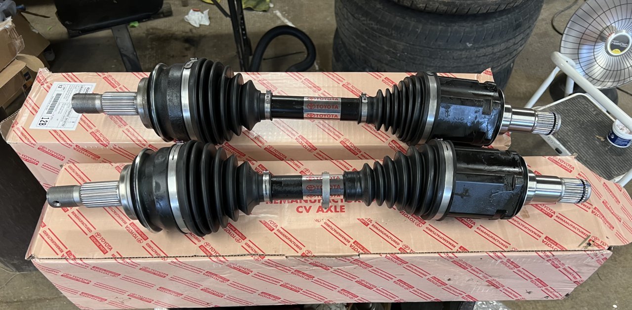

    Bought a pair of reman CV joints and dealership parts guy told me it’s on back order bc Toyota doesn’t have many reman CV I would probably get NEW CV for the price of reman. Score :thumbsup:

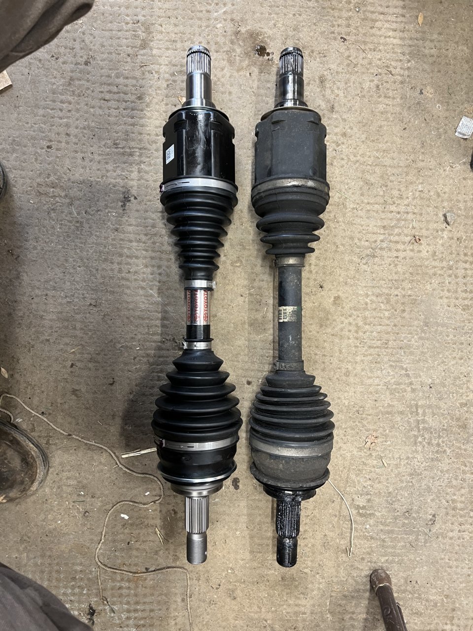

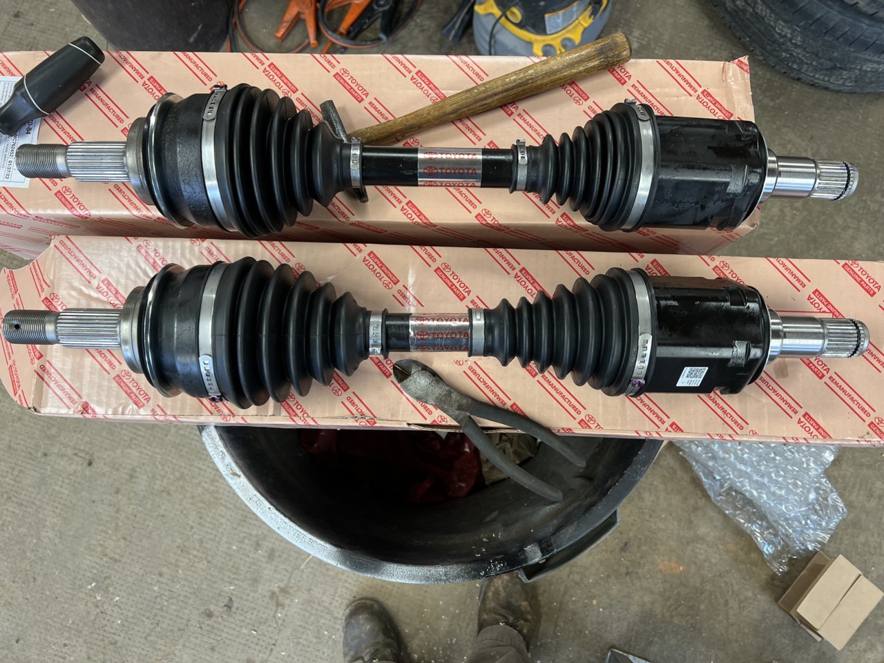

    Interesting note. I just got a set of these and noticed the boots have a different count of ribs from my factory axles (see attached pictures) and both appear to be made of the same material (my thinking and the way it feels leads me to believe neoprene). If I do the boot stretching method for my lift config the Toyota sticker might be the only thing visible (bottom cv axle has inner boot stretched. Not outer) Just some things I noticed. I didn’t go with a reboot kit because the bearings have 170k on them.

    If anyone else gets these and finds out they need to boot stretch for their lift see attached links to some high quality and much cheaper clamps than Toyota. You might get away with two sets of the CV38.5BAND9 clamps but this is what I used and I might’ve tightened the outer boot a little bit too much but at least it won’t slide back:D
    Outer boot(small clamp):https://belmetric.com/9mm-band-stepless-ear-clamp-oetiker-167-stainless/?sku=CV37.6BAND9
    Inner boot(small clamp): https://belmetric.com/9mm-band-stepless-ear-clamp-oetiker-167-stainless/?sku=CV98BAND9
    Before(Top) After(Bottom)
    17taco4x4 likes this.

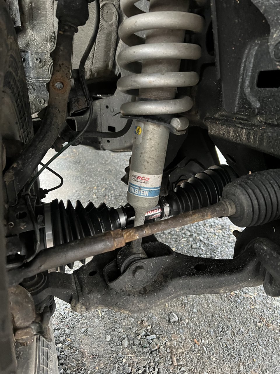

    I think it should be fine. Only thought I have is with these boots being longer than my factory ones is how close they will be to the shock. See attached pic of stock axles.

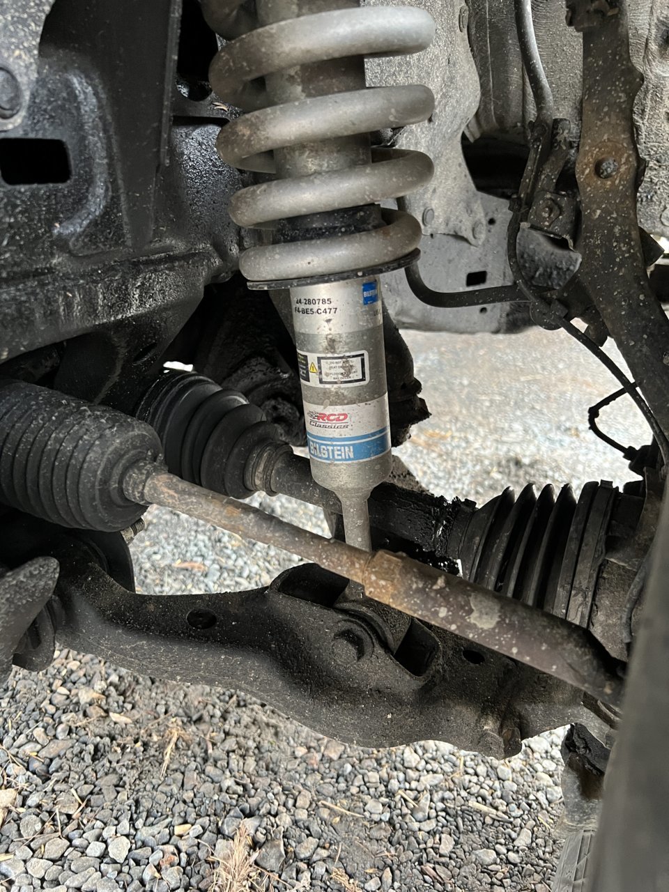

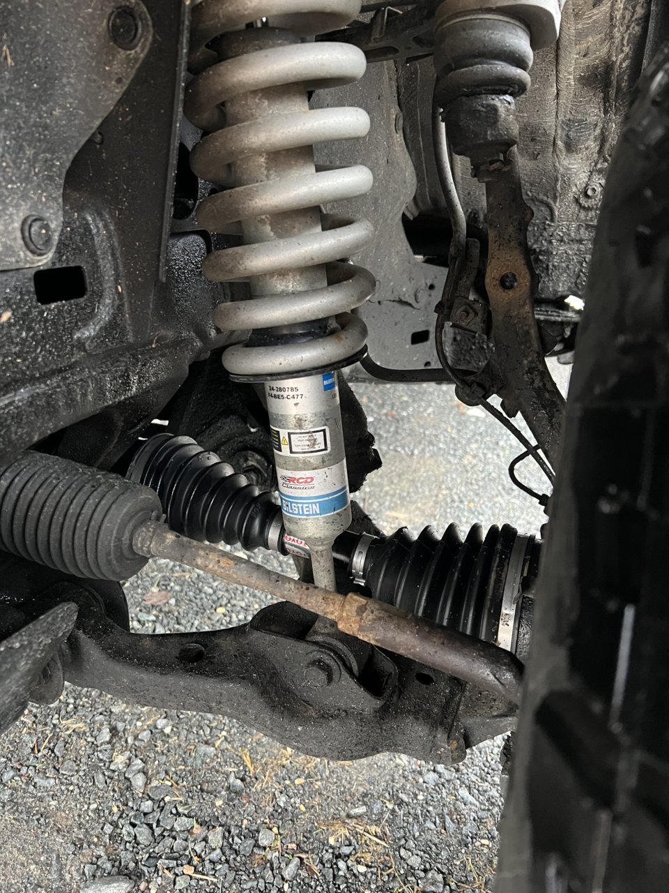

    Pics of driver/ pass cv angles with stretched boot and side by side comparison with factory 170k axles.

    It’s a toytec eibach/5100 lift and they claim 3 inch…. My guess after 60k I’m at or around 2-2.5inch. My cvs have always been at a good angle with no diff drop.

    Just saw this thread after you posted, and it got my hopes up.
    Bad news all around is... that QR code sticker posted on the first page? That's an A1 Cardone thing... makes me about 99.9% sure they were A1 Cardone with a Toyota sticker & PN.
    And worse... I think A1 Cardone is killing their CV axle remanufacturing. I sold them at work, and we discontinued the remans, our new new ones are now Trakmotive. I'm not 100% certain Cardone killed the whole line, but other places I source from also almost never have any available anymore.

    I could be wrong, it could just be a coincidence, but that QR sticker in post #8 is dead nuts what I see on our calipers & boosters that Cardone remans, as well as Cardone P/S components I occasionally see. The 'lifted truck = no warranty' tag is the same too, and that Made in Mexico black sticker looks hella familiar too...
    Awful lot of coincidences there to convince me that a manufacturer (who probably isn't even manufacturing their own CV axles) has their own remanufacturing operation, though. And that it's also coincidentally in the same country that other company (who totally isn't remanning ours) has their remanning operation.
