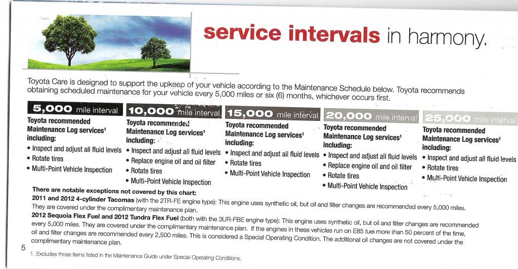

    ewrob
    ewrob Well-Known Member
    Jan 10, 2012
    #70346
    57
    Ernie
    NC
    Base Truck

    Whatever.
    This is in conflict with information that many others have been given by Toyota.
  6. Nov 25, 2012 at 10:31 AM
    #46
    ewrob
    Jan 10, 2012
    #70346
    57
    Ernie
    NC
    Base Truck
    Conflict
    toyota has it wrote out in black and white,go to a good dealership they will give you no problems with your 2011 and 12 tacoma 5000 mile oil change that is covered under toycare,im just tring to keep tacoma owners from making a large investment in their truck then do the wrong service intervals.my wife owns a 2012 corolla and it has a different engine than the 2.7 tacoma and it does go 10000 miles between oil changes,this should be the end of this discussion

  19. Jan 2, 2015 at 7:53 AM
    #59
    ewrob
    Jan 10, 2012
    #70346
    57
    Ernie
    NC
    Base Truck
    You need to find another dealer,the 2012 tacoma 4cyl oil change is every 5000 miles.i went thru this with my local dealer,i have papers from Toyota that the engine in 2011 and 2012 tacomas oil change is every 5000 miles with synthetic ow/20wt
