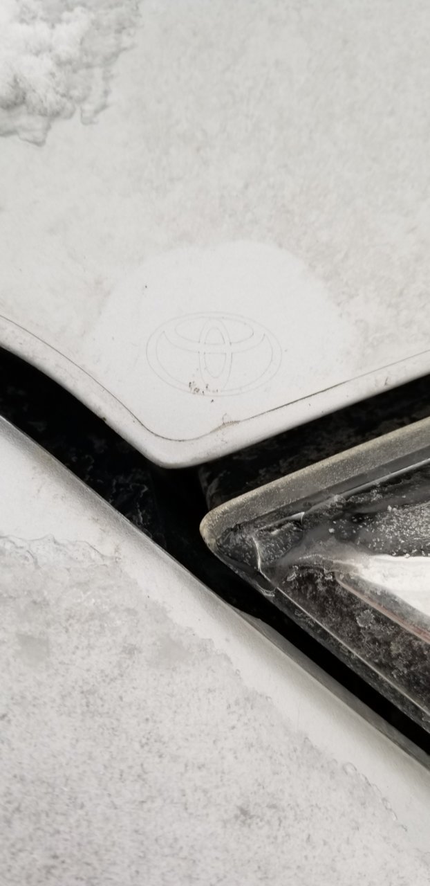

    here is a pic of my oem paint film on my 14 4runner. I can get a pic of the 18 tundra with oem film after work today. I don't have the Tacoma anymore so I cant get a pic of that but I am positive all Toyota oem films have the logo on them. just to add, all films attached to the 4runner have the logo on them. there is 3 parts to the 4runner film protection, front hood, and the 2 front sides of the front fenders.
    @TriniPhantom

    Thanks @NoDak much appreciated.
