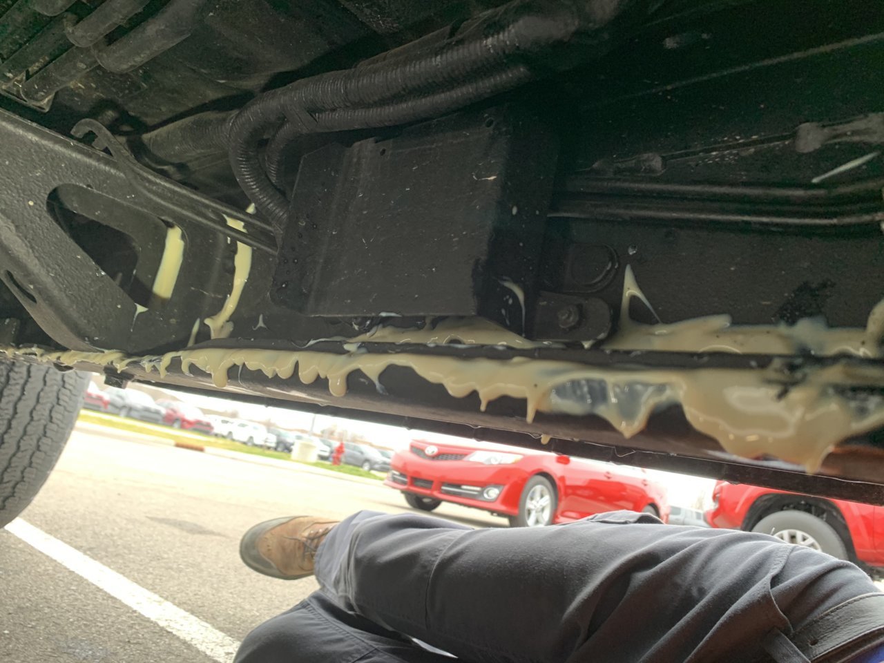

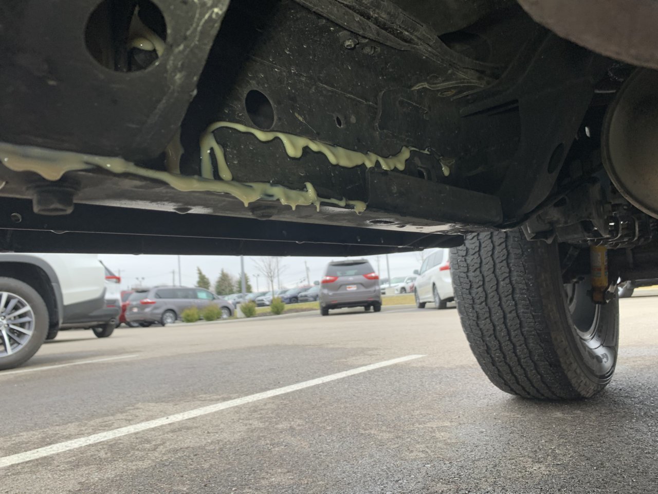

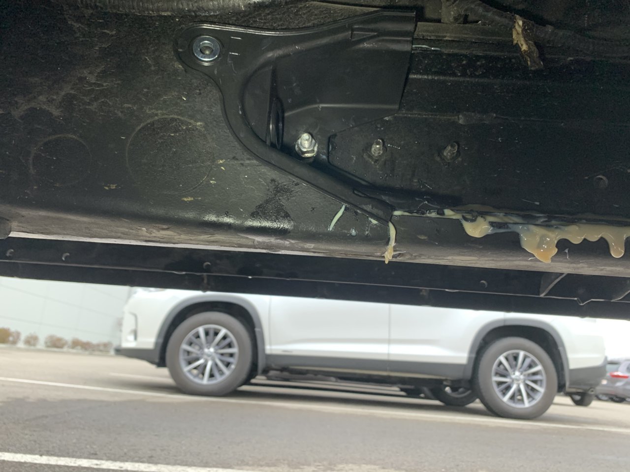

    I just picked my truck up from the dealer after having the rust prevention done. They always described the treatment as a spray so I assumed it was a form of a rubberized undercoating. After receiving the keys I took a look underneath and see what looks like white grease. E2C958AD-5B69-4596-9F62-25EE3D9B83B7.jpg232560C9-D72E-4D68-A52A-136B6AB1E2C0.jpg
    The service manager assured me that this is normal. They plug the frame and shoot it with this grease like substance until it comes out everywhere. I even had huge globs on my exhaust.
    Just figured I would share because this was not what I expected at all.

    Yeah the goal is fill up the small space between the sandwiched sections of frame to preclude rust starting there. On the previous campaign for 05-11 MY they were using some garbage wax coat that did fuck all. I assume the 05-11 campaign was a bandaid to appease owners and also cover their own asses.
    This new stuff has more promise in preventing rust where it is actually starting. These frames don’t typically rust out starting on the external or internal rail but rather in between. Hence all the added frame plugs now over the years. Like the large cap covering the opening to the boxed section of your frame. Lack of caps lets road corrosives splash up and in between the sandwiched metal.

    Looks like someone took your poor truck to a bukkake shoot dude.
    actually if that’s all in the frame rails I can see it doing a good job preventing rust. But isn’t this stuff dripping off. What if you parked on a 30k dollar driveway with pavers.

    I hope that quote is the appropriate way to respond. Either way, they originally sent me on my way telling me nothing. After looking at my truck and thinking the same thing, I asked, and they said it will not stain and will dry/harden over the next week but also said Toyota recommends not parking in the garage. At this point it doesn’t seem to really be falling off but you can smear it. I park in the street anyways so I’m not too worried about it.
    Supposedly it fills all the little cracks and crevices in the frame because that’s where the rust gets bad.
    Also I might add that the machine they used to inject the stuff broke twice so it took longer than expected.

    It looks like a thorough application job. Oozing out of the frame joints is a good thing. I live in the southwest and I want it done to my frame:)

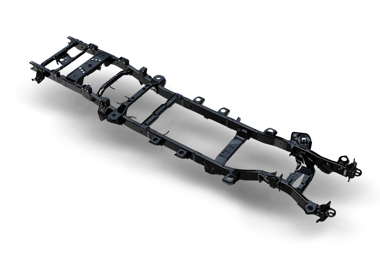

    My guess is the next generation Taco and Tundra (TNGA) will share the same frame rails from front to back and simply have different width cross members. I think this design would yield huge manufacturing and assembly efficiencies. Curious to see if the next frame will be fully boxed like some of the competition or a combination of boxed and open C-channel like the current model.

    It’s a wax they use. Whoever did yours just did it sloppy. The guy we have doing
    Them does a pretty clean job on the visible stuff.
