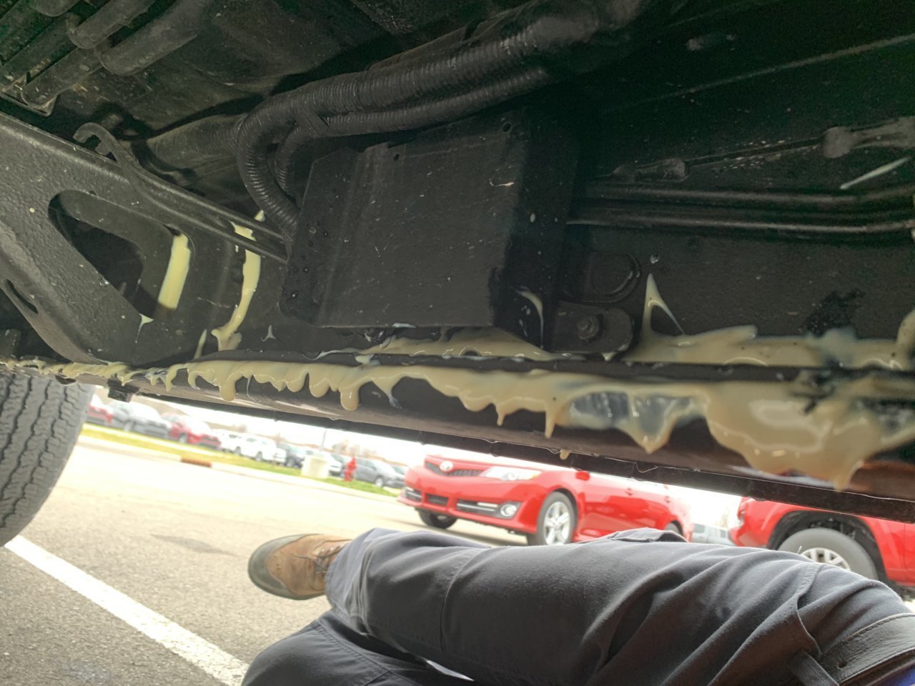

    Rust is worse. Been there and done that. I am having my 2017 done and if the "crap" isn't running everywhere they will do it again. I don't care about pretty, I want effective. I can't see it from the drivers seat and if someone wants to crawl around under there they can have at it.

    It appears that the dealership has a long wand to insert into the frame openings.

    long wand, special heater and pump, a massive wirewheel brush thing to use inside the frame rail and a 3-4 hour dry out of the frame before anything is done
