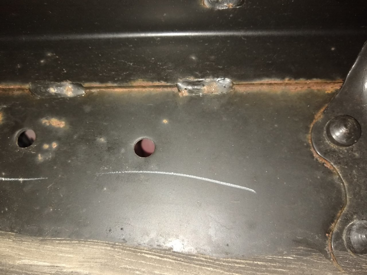

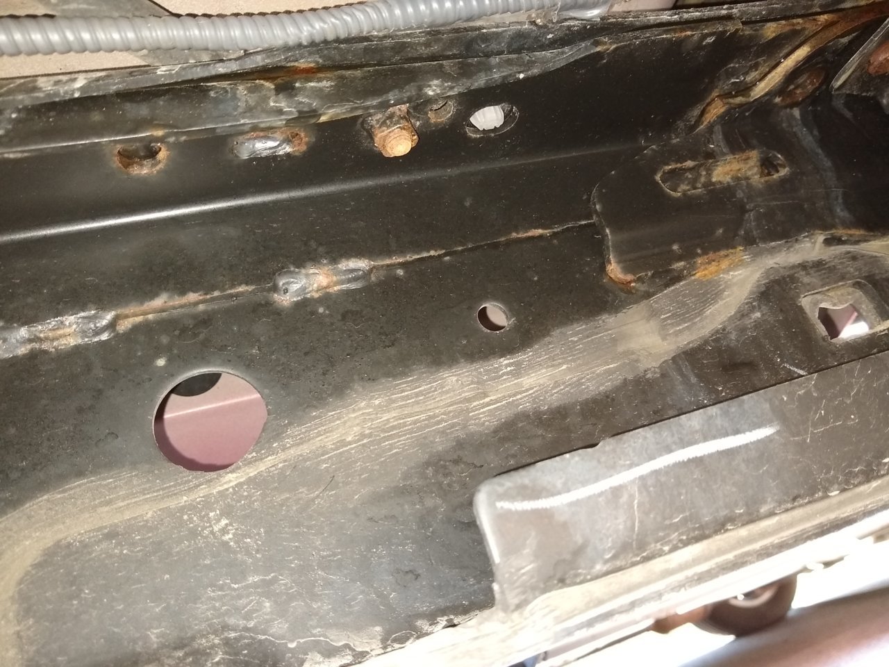

    I just checked it and all it looks like is paint.

    The dusty film appears to be remnants of the wax. It’ll only be on the inside of the boxes section of the frame.

    The soft pliable crap is visible in the square hole in the 1st picture in TacoSportTRDs pics.
