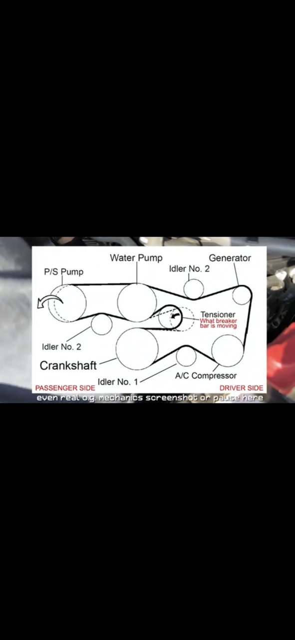

    Some auto parts stores have loaner tools. (It’s just a long breaker bar, so you have enough leverage on the tensioner.). Take a few ‘before’ pics or use the diagram above. Once you do it, you’ll realize how simple it is. It’s literally a 5 minute job.
    Stealership $750 vs DIY $50
