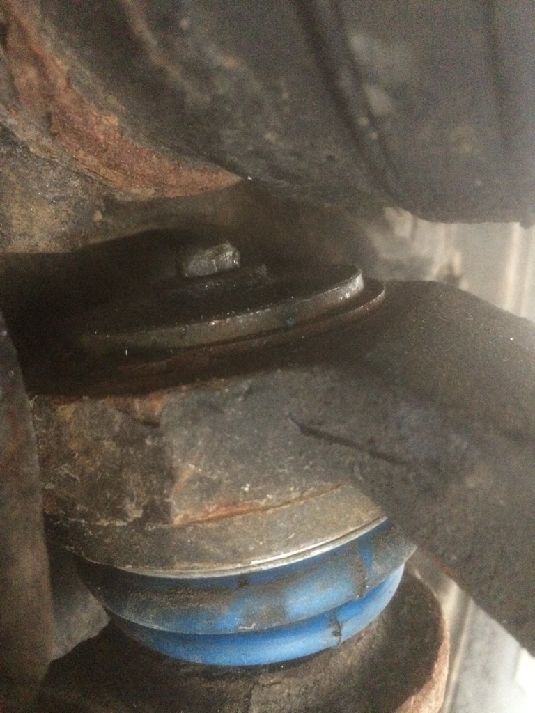

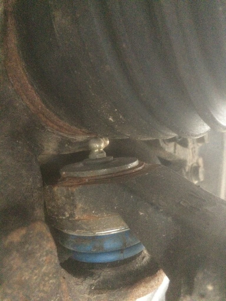

    Upon return of my truck, I note the occasional hum/grind on the highway, particularly when cornering. First thing that comes to mind is wheel bearings, so when I get home, I jack the truck up to check for play, and noise. I clearly hear the grinding again, and upon closer inspection find this:
    Youtube vid for clearer example:
    https://www.youtube.com/watch?v=uV8VzESKvxs
    Pretty surprised to find this, and I distinctly remember the old LBJs not having a zerk fitting, so I look up the part number on my invoice (MS86527), and find it to be some cheap aftermarket replacement part.
    Now I am a little angry, so I contact the dealership and request this be fixed. I send an email with pics, and after not hearing back for 2 days, I return in person and speak with the service manager. He gives me a bit of a runaround, and states that the tech that did the job is on vacation, so he can't ask him about it. The tech that installed it is the one that has to repair it, so they won't be able to fix my truck for over a week. He mentions they will just remove the zerk and cap it for more clearance. I argue this should have been a genuine toyota part, and why was it even used in the first place. The service manager states that the OEM LBJ is not sold alone, and comes as a lower control arm assembly. This is their alternative to it.

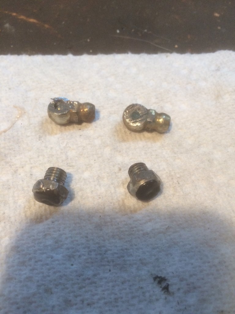

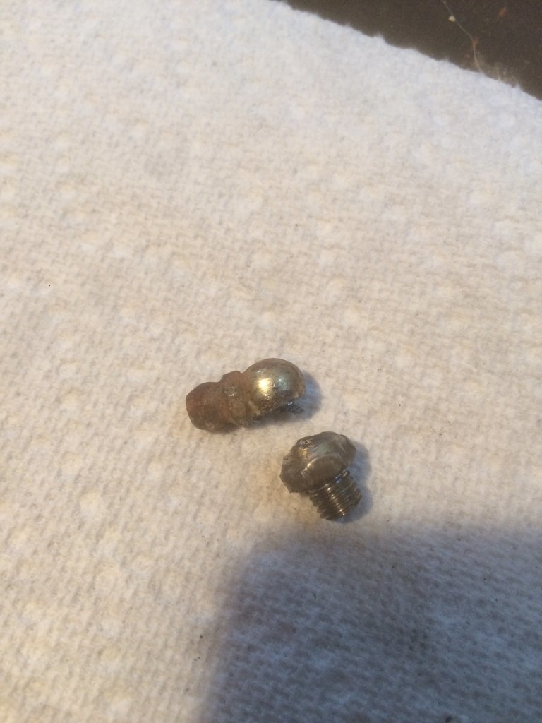

    When I get home, I decide to try and fix things myself, as I have a long road trip coming up to run a trail with some buddies in 2 days, and don't really want to have to deal with this anymore or knock out a zerk fitting while on the trail.
    Using a small metal saw, I am able to cut the head of the zerk fitting off, which gives me room to unscrew the entire fitting:
    I then seal the threaded portion with some JB weld and allow it to dry:
    I am able to use the treaded portion as a cap, which seals the LBJ back up, and instantly I have clearance again!
    No more noise!

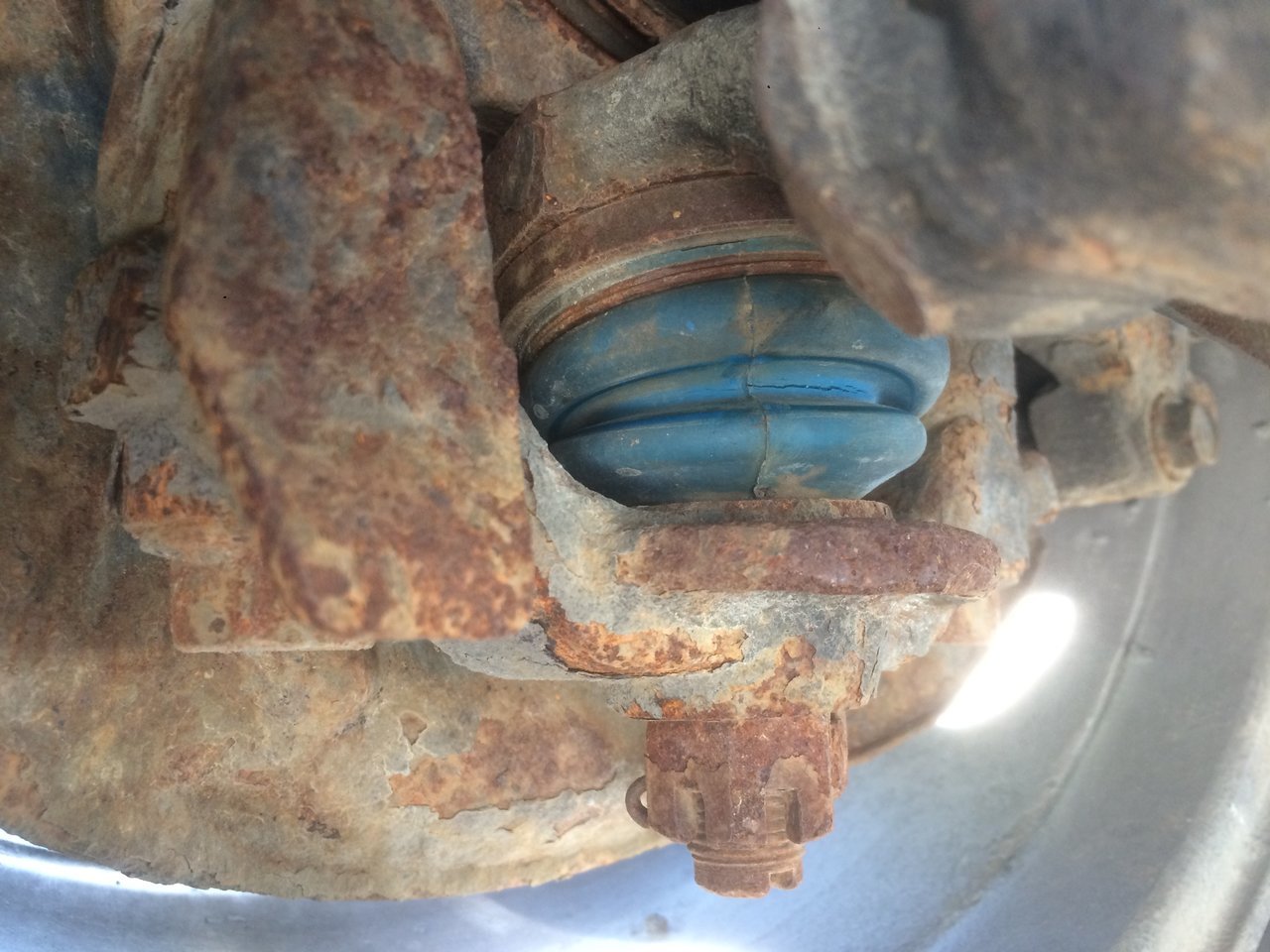

    6 months later, after having put about 9000km or so on the truck, I have a road trip coming up, so I decide to do a nice check over on everything (fluids/breaks/lube/suspension). I jack up the front to check for any wheel play, and discover my right front tire does have some wiggle to it. When pulling the tire, you can hear a little clunk and see a bit of movement at the LBJ.
    Looking a little closer, I can already see cracking starting in the boots:
    What the heck! These are still almost new!!!
    What do you guys think? Should I fight this or just deal with it myself?
    I emailed the dealership to see if they offer any warranty on their work, but I am expecting a solid no, or expecting that once they inspect it, they will blame the failure on my zerk repair. Haven't heard anything yet, will update when I do. Thinking of escalating this to Toyota Canada.

    Quick question,how did they replace anything,that nut in the picture dont look like it has been removed in years.
    EatSleepTacos and outlawtacoma like this.
  4. Aug 3, 2017 at 12:42 PM

    Yah, I agree, looks pretty bad, but unfortunately thats what one Canadian winter will do to unprotected parts. The salt they place on the road is terrible for the underside of the car. I always have my vehicle undercoated (oil sprayed) before winter, but the shops don't usually focus on small parts like this, just the frame and undercarriage.

    Damn,that much rust addition in 1 year.
