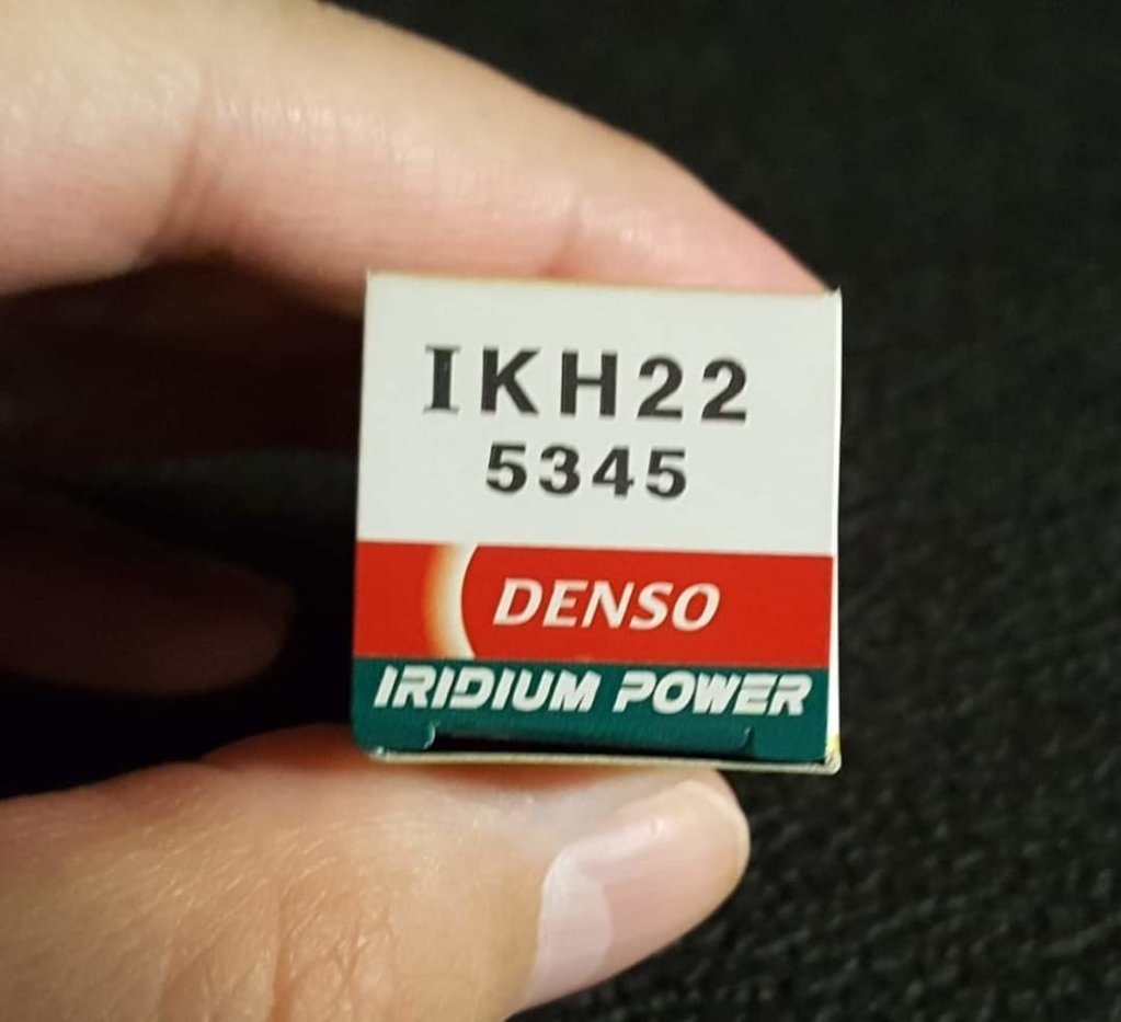

  15. Jun 8, 2024 at 5:07 PM

    Red DCLB Tacoma
    Trd intake stuff More intake stuff Kdmax pro 10.0 yayayaya
    :crapstorm:I used these after the OTT flash tune. :crapstorm:
