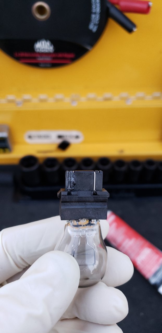

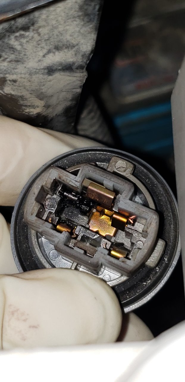

    Seems about every other trip the washboard experience in DV will cause this to happen to my front driver side blinker bulb and connection. Vibrations cause just enough gap to form between the contacts on the bulb and the contacts on the connector for an arc/spark to happen resulting in a short resulting in non working front blinker.
    Remedy has always been to clean/remove any debris, and to install a new bulb with some dialectic grease on the bulb contacts..

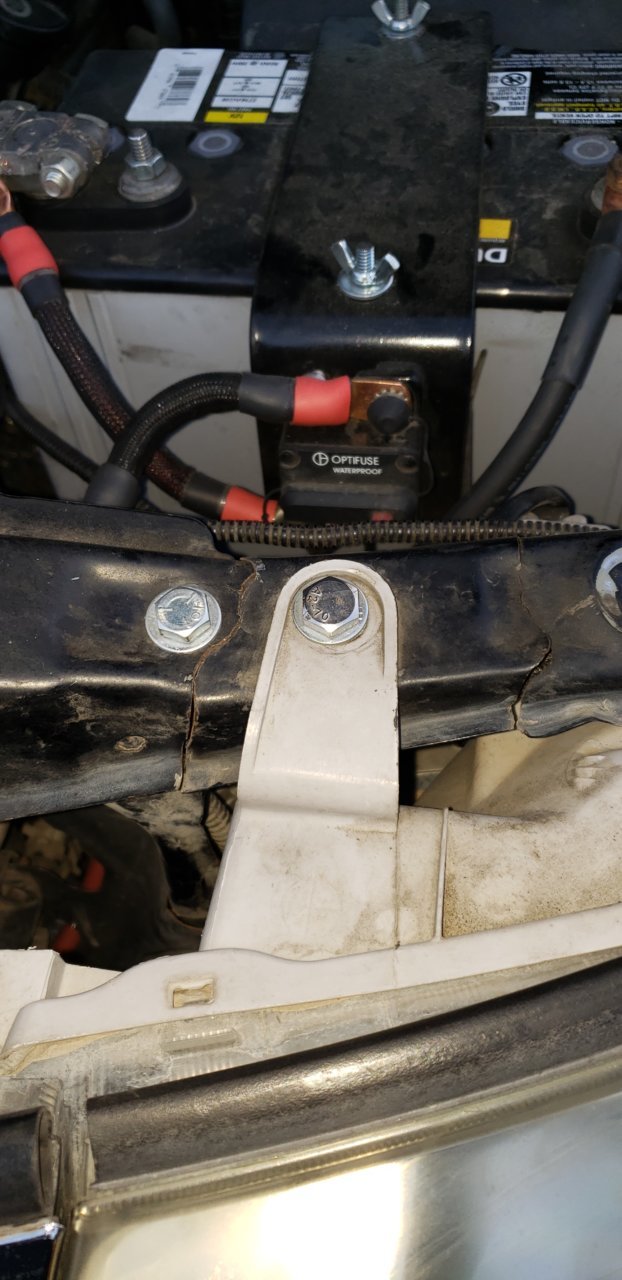

    Random question... did you install poly radiator support bushings? I’ve got multiple cracks in my core support and someone suggested to me that the stiffer poly bushings may be a big part of the problem.

    I'll see your cracked cross member and raise you a driver rear shock tower that broke 6" of factory welds and ripped off the crossbar. It also cut my rear ABS wire loom in half. I was wondering why my ABS light came on and the speedo kept dropping out. lol

    I do have the Poly bushings, but they were installed at the time when I started to notice the cracks/separation in the numerous spots. I doubt the more rigid poly bushings played any role in worsening or prevented what's going on in there.

    I have the core support bushings but I don't blame them for my cracked core support. There are too many other owners who also suffer from poor material failure. You'd think Toyota would strengthen the areas that have a poor track record.

    I’m not blaming them. I just wonder if they add to the strain of a flimsy design on rough roads

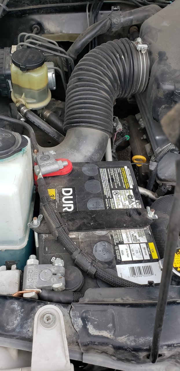

    Hey Proof, do you have your dual battery under the hood in the stock location? I skimmed the first two pages of your build page but didn't see it. I am beginning to think the radiator core supports crack with the extra weight of the batteries. I am getting ready to build my dual battery set up and am leaning more and more on the side of putting the Aux battery in the bed.

    I do, and the weight of my old 31M absolutly affected the integrity of my core support. I relocated my power steering reservoir to make room for the Aux battery. I have added gussets to rebuild and to reinforce the entire core support. I have also seen failure with just a stock battery as well so the problem is just not related to a heavier aftermarket battery.
    Edit: I would consider placing the Aux. Battery in the bed, or if you had the space near the back of the engine bay on the passenger side.Some of us do and some of us don't depending on where the ABS module is located.

    I had my 2nd battery in my engine bay on the passenger side near the firewall. The mount broke from off-roading. I now have the 2nd battery (agm) mounted to the floor behind the passenger seat.
    The stock battery has contributed to the core support failure.

    dont those need to vent outside?

    I only have one battery, group 27f AGM. But have cracks on both sides of the support, plus several inside the engine bay. Apparently it’s pretty common with these trucks that get lots of off road use. There’s a number of threads on TW about it
    Seems like the culprits may be:
    proper off road use (lots of washboard, whoops, desert racing, or aggressive rock crawling).
    Heavier than stock or dual batteries
    Heavy front bumper/winch that that can put more force on the core support
    Several people have suggested to me that the stiffer poly bushings mean that the jarring force of off roading coupled with heavier batteries and front bumper weight can put more stress on the core support.

    The otherside to the bushing argument is the softer OEM bushings allow more flex to happen in those key areas , more flex increases metal fatigue....
