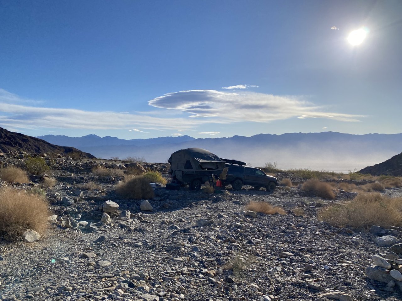

    Had to hide out in the canyons last night. The wind/dust in both Panamint and Death Valley was brutal.
    This was 9am this morning looking east into Death Valley.

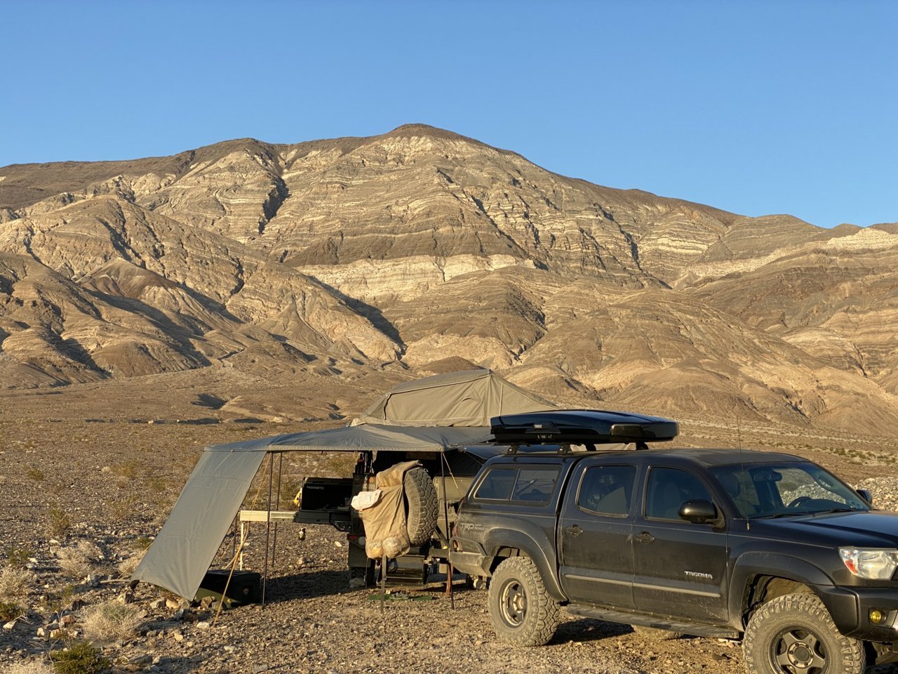

    Camped in Saline and Panamint valleys the first two nights were great though...other than the gnats that we're out at the dunes before sunset.
    It was warm enough Friday evening that the awning and awning wall were welcome for shelter when cooking dinner.
