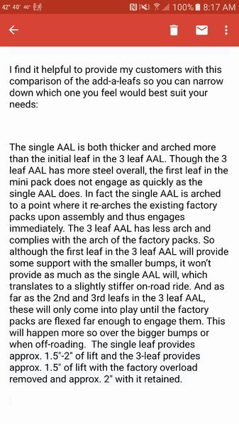

    This is from an email Marie sent me a few months back.Screenshot_2017-01-04-08-17-45.jpg

    All of the 3 leaf progressive AALs on the market are manufactured by Deaver to the same specs.
    So, get which one fits your budget or your ego (like Icon).
    The 3 leaf packs are not as strong as a single AAL, so if you're towing or hauling heavy/regularly you'll be better off with a single AAL, though your unloaded ride will be slightly stiffer.
    Lastly, if you install a 3 leaf AAL without your factory overload leaf, you'll have a 10% loss of payload capacity.

    Our 3-leaf add-a-leafs and Icon's are manufactured to different specifications and they are not manufactured by the same company either. I am not sure what other manufacturers' 3-leafs look like in comparison but since we sell ours and Icons we are familiar with both, their similarities and their differences.
    If you would like to go over some of the differences of ours and theirs or the single leaf vs. the 3-leaf you can either pm me or give me a call and I can help you out.

    The height difference from 2nd gen to 3rd gen is really only a front end thing. Typically the rake (depending on model year and if they have the recall pack or not) on the 2nd gens is greater then that of the 3rd gens due to Toyota putting a different coil spring up front.
    So if you use the Deaver single leaf add-a-leaf it will provide approx. 1.5"-2" of lift over stock. The 3-leaf will provide around 1.5" of lift with the factory overload removed and around 2" with it retained. The OME Dakar will provide around 2.75"-3" of lift over stock fully in tact but you can alter this pack to gain more or less lift, and from what I have seen the J66 will provide around 1" of lift.
    If you need help with your specific truck and what the after lift measurements may be let me know and I can go through it case-by-case since each truck can have some variation.

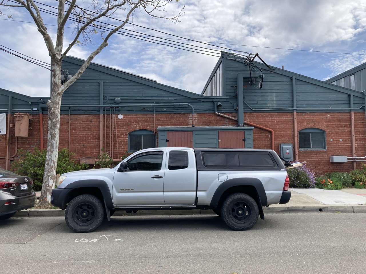

    How’s it working out so far? Considering the same but concerned my camper may load it down. Wanting to still have some spring for when I need to load up the back with materials.
    this is it rn with factory leafs.

    Add airbags and you can adjust as needed depending on load in the bed.
