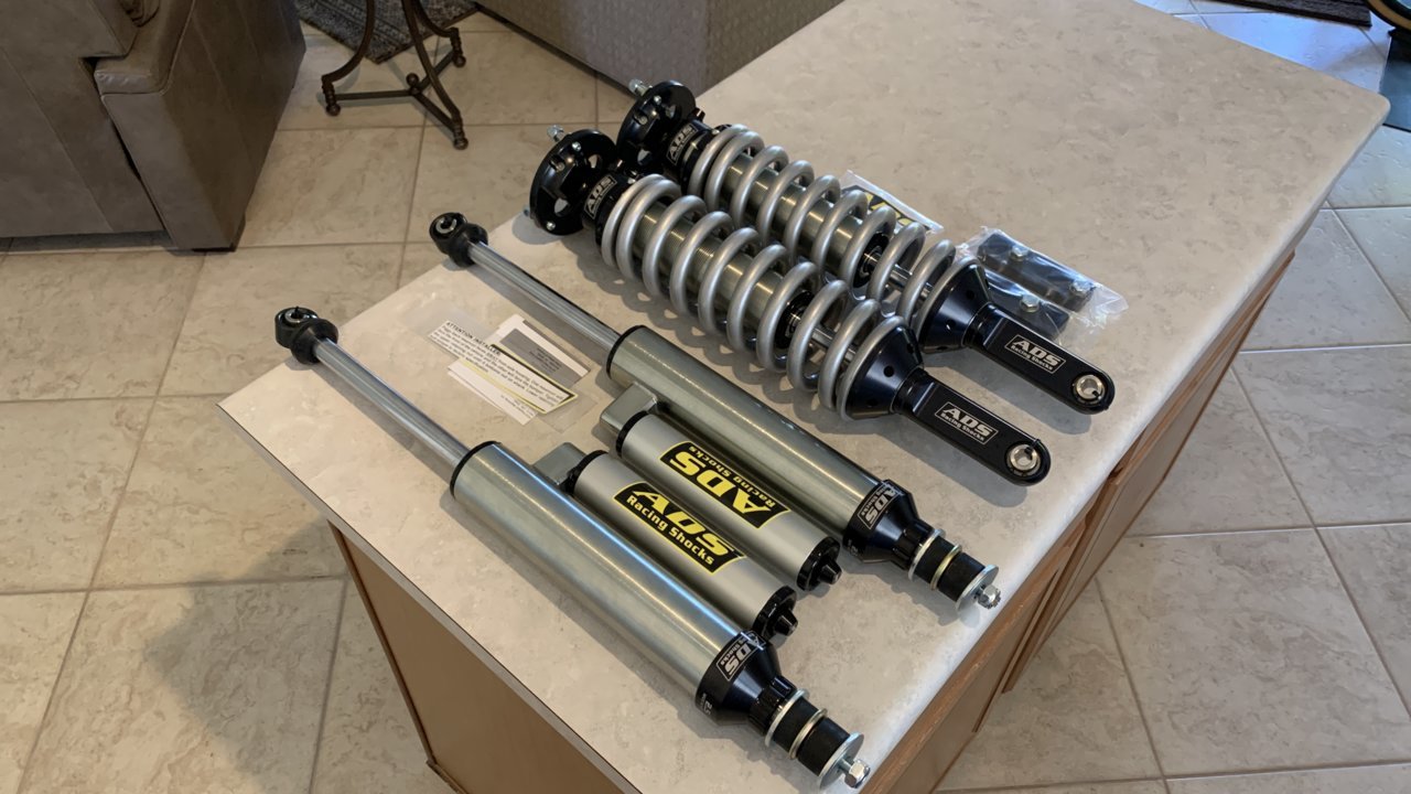

    Nope. The only thing that gets replaced is a bolt right in the center of the pack (comes with the Deavers). The stock overload and all other leafs stay. You just add the single Deaver leaf. Simple. Looks stock. You wouldn’t know anything was done, other than the 1.5” lift.
    The only concern I had was overworking the AAL and stock pack when towing/hauling, so I added the Sumo Springs. They are also dead simple and don’t touch or do anything until enough load is applied. Together, they are a simple, relatively inexpensive way to cover the needs you expressed.
    On the more pricey side, I added aftermarket ADS Level I shocks front and rear, along with 650# coil springs to raise the front 1.5” and keep the rake stock. I off-road regularly on moderate trails in AZ, and these shocks and coils are HEAVENLY! Waaay more control from the suspension; way fewer hits on the undercarriage, but this may not suit your needs.
    Solid Deaver install.
