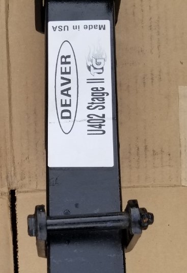

    So I have a question. I have Deaver U402. How do I know which stage they are, other markings are D10045L29 and 63433. Any help would be appreciated.

    measure the thickness of the stack. It's been a little bit, but I believe the Stage I is 3.5" thick and the Stage II is 3.75" thick... At least it was for my two sets. They also should have a sticker on the top.

    look on the labels. They will say U402R and U402L :thumbsup:
