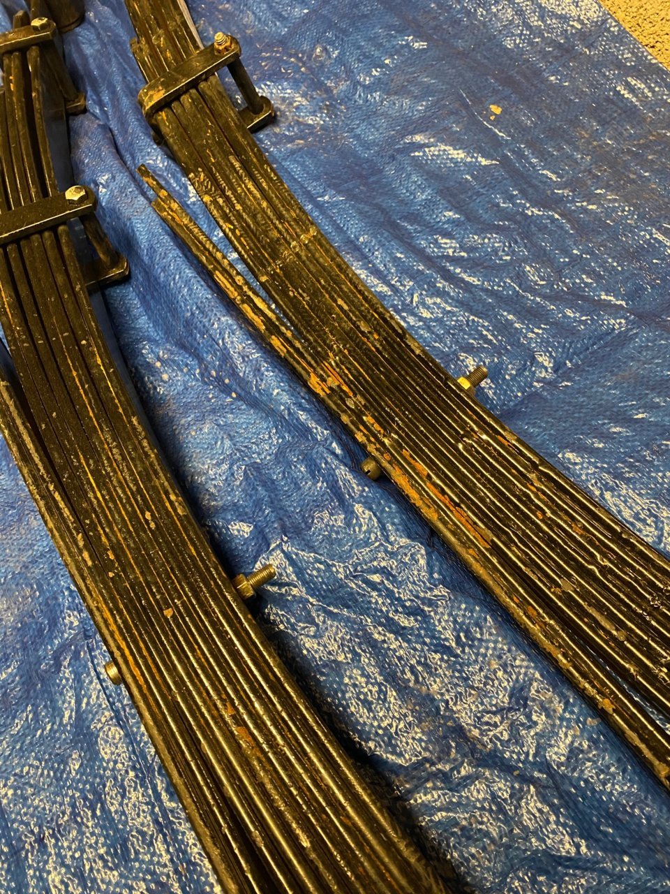

    Had U402's Stage 2 mounted for a bit last winter and took them off as truck was nowhere near built for them yet- I'm gonna put them back on here soon, and even though I'm in Arizona they've corroded a little. I'm not worried about it, but wondering while they're off the truck what treatment I should give them before remounting- Wire wheel brush? paint them with Rustoleum or...? Dry lube, WD-40? Don't do anything?

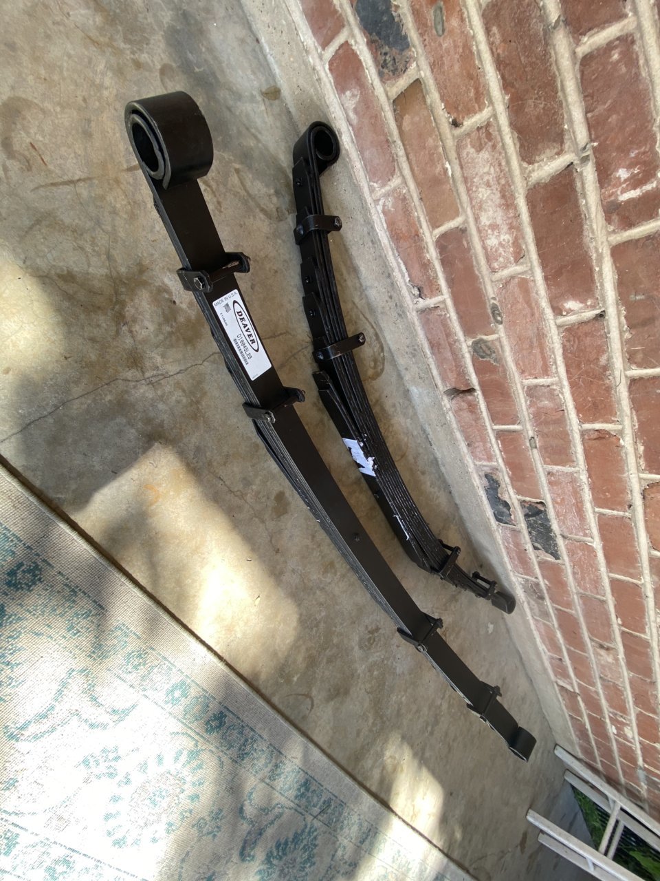

    I just installed my stage 1 Deaver’s today and what a difference in ride. Compared to stock springs and a block lift. Much much better. I need some rear shocks now!!!!!!!upload_2020-11-21_15-34-27.pngupload_2020-11-21_15-34-29.png

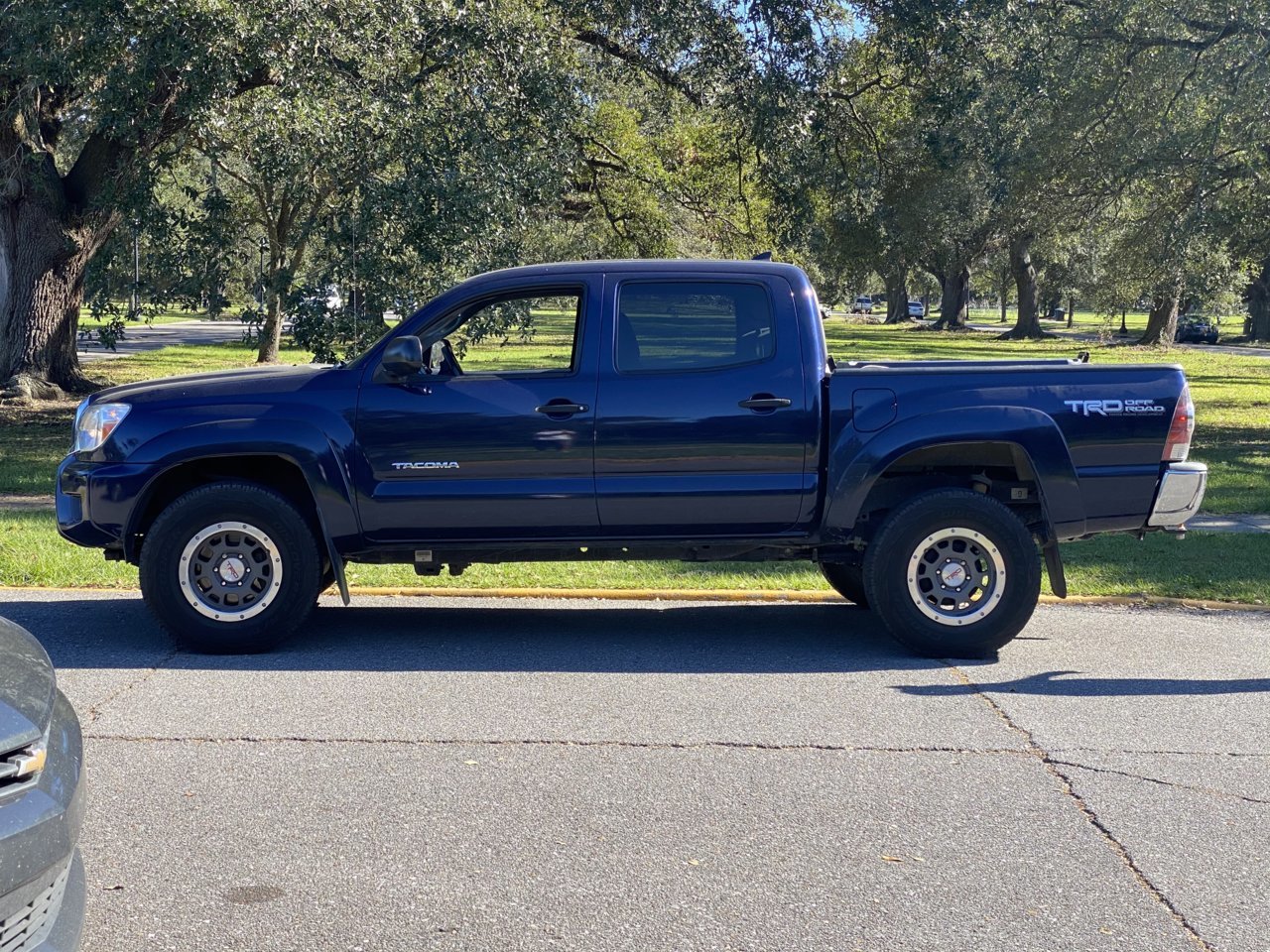

    Put my Stage 1 leaf pack on today. Rear of my 2013 DCSB 4WD TRD-OR came up exactly 2.5” over my sagging 3+1 TSB springs. RIDES SO MUCH tighter, corners better, no bottoming out on a big dip on my road, braking and accelerating seem more solid.
    A ton of rake with my old 883s up front, 884s arrive tomorrow and will hopefully lift front 2” to match.

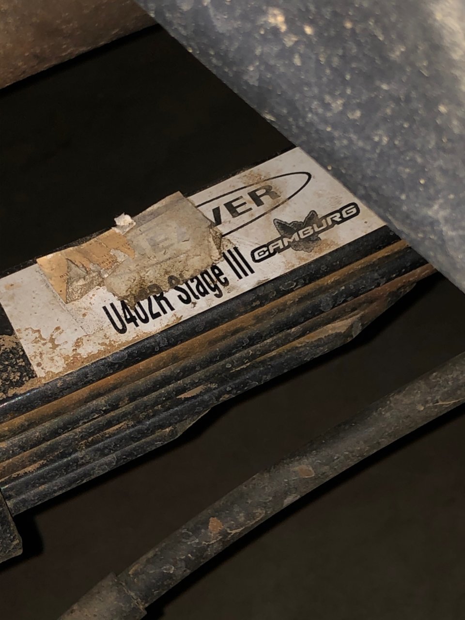

    About to start my install of the deaver stage 3 and I wanted to know with the U402L goes on the driver side and U402R goes passenger side?
    Clay Jeezy likes this.

    L stands for the "light" side... so the passenger side, without the battery and gas tank. R stands for the "... I've got nothing...
    Yes, R and L for the right and left, from the driver's perspective.

    Hey gang, there's an actual L to R orientation? I just called Deaver and they said there wasn't. I got my Deavers second-hand, and I don't have a "Deaver" label on them.

    I think it depends on the stage. From my own experience, stage I and II were NOT side specific. I feel like I've seen some of the stage III boys say that theirs were.

    Mine were side specific

    Your stage II's or III's? I know that Deaver designs each pack individually, based on materials (more or less leafs depending on thickness of leaf material)... so, it could very possibly be a case by case basis. I have photos of my stage II's that show there was no specification left or right.

    III
