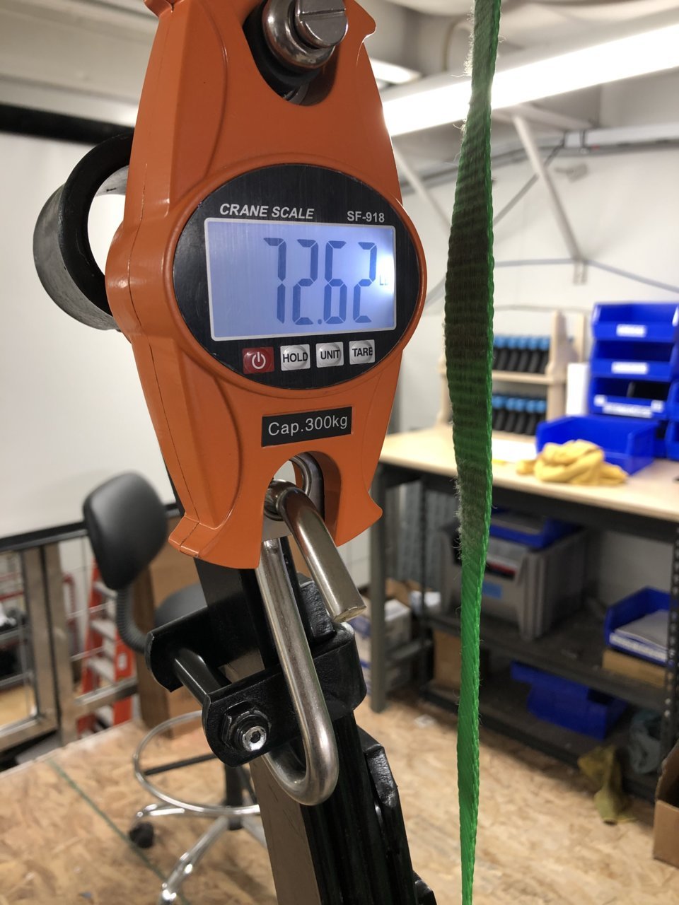

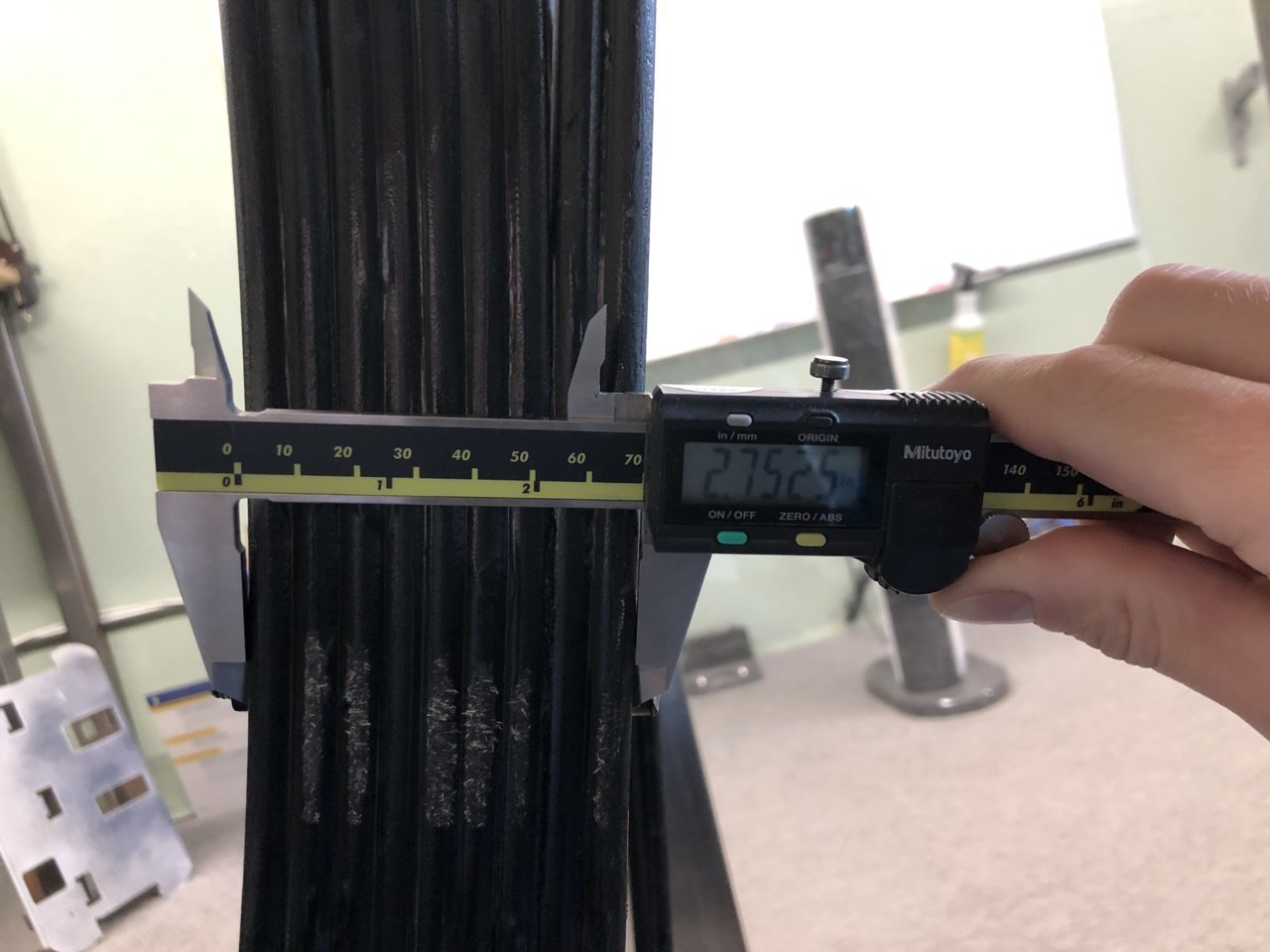

    U402 Stage II just arrived. I totally underestimated how big these were. 2.75" thick at the clamp, and almost 73 pounds each without bushings. Still waiting on shocks from Radflo before I get everything installed.
