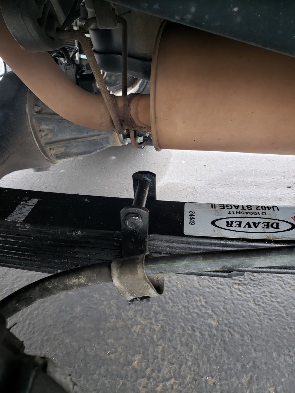

    To mount the parking brake cable I drilled and taped a hole in the bracket on the Deaver's, it is an M8 x 1.25. To do this I removed the Deaver bracket bolt and wedged a pry bar in between the bracket and leaf pack to create space for drilling and tapping. The stock bracket bolted right on and with a slight angle tweak on the brake cable bracket it is perfect.
