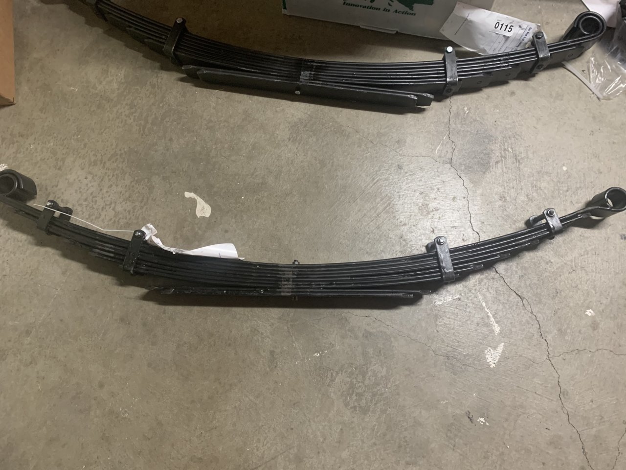

    I just got my Stage 2 Deavers in and was wondering which side goes to the shackle and which goes to the solid hanger

    Double wrap forward
