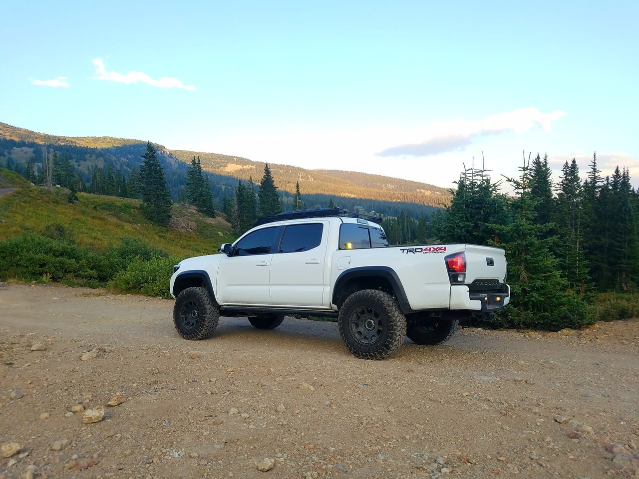

    So in the second setting, the rear sits slightly higher than the front -- note that up front I am running 700# springs with about an inch of preload, so it's sitting pretty high as is. I can say that fully loaded, those springs sag about a half inch, well a little less actually. But the on-road ride unloaded is actually very smooth, comfortable and controlled. It truly is a very impressive leaf pack, Icon surely did their homework when developing them and it shows in their performance. I just took another trip up to CO over the weekend which was the first time I really got to flex out the springs and again, was extremely impressed with the amount of flex, while still providing a nice smooth ride in the chunky shit.

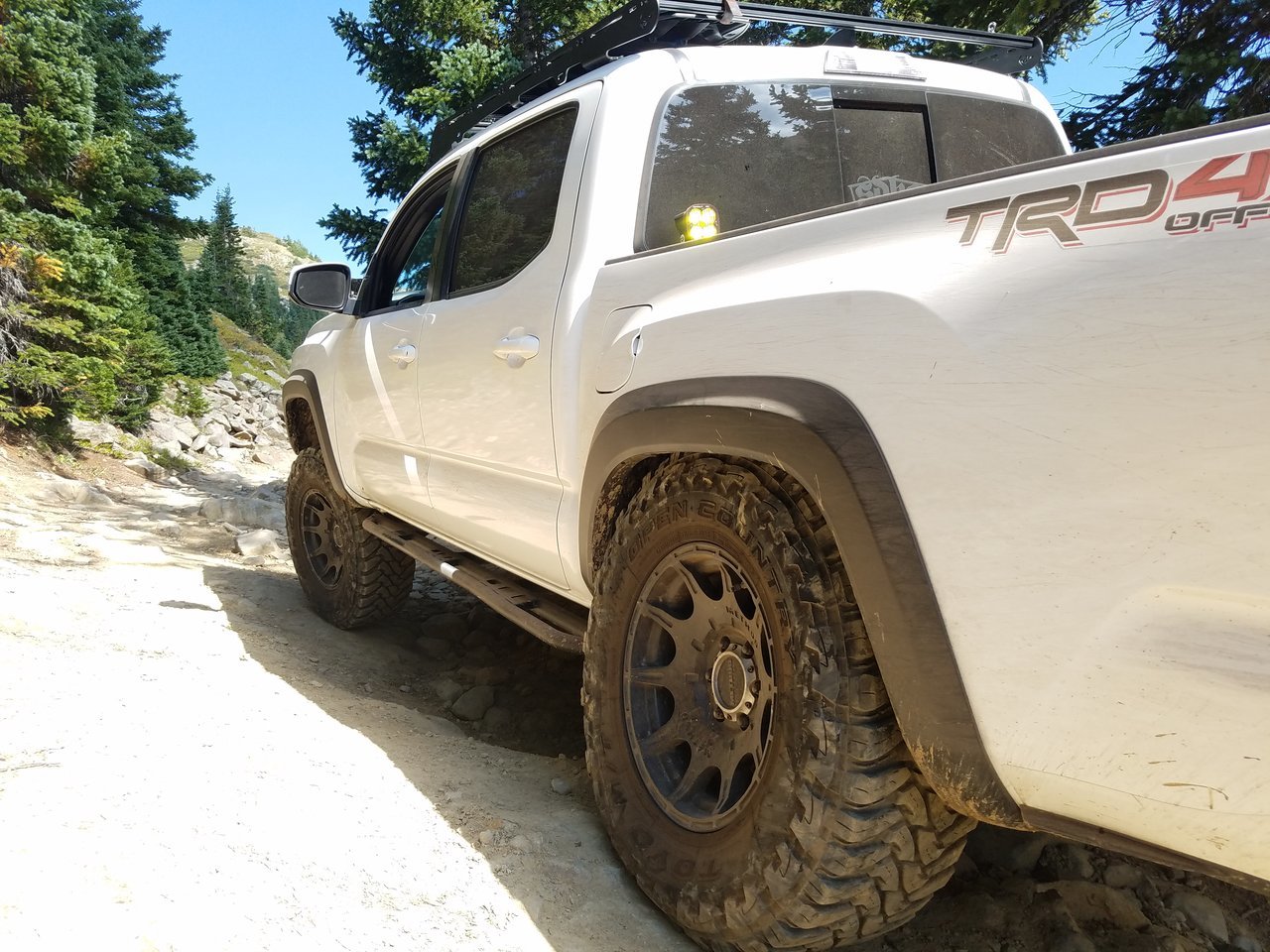

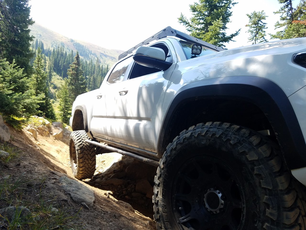

    Here's some flex pics of the springs in the second config as well as a profile to give you an idea of height

    That's impressive. The profile/stance (and you truck) look great! Is that with minimal load?

    Thats just got my RTIC 45 full of beer, some recovery gear and some other odds and ends, so yeah, just minimal load. I ran the springs in the base setting for a few weeks, and did two fully loaded trips with them to break them in, then I changed them to the 2nd config, so they are reasonably broken in, but may settle a little more? in which case I can go up to the 3rd config if need be. That's one of the things I like most about these springs, the ability to reconfigure them as needed. Aside from that, I did come from u402's which I loved and thought couldn't be beat, however these RXT's are impressing the hell out of me and in the second configuration sag less than the 402's did.
