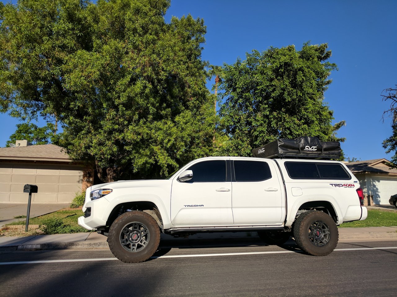

    Guess I'll jump in here since I'm now running @JerryTaco 's Deaver u402's and Icon 2.5 rears.
    I run a cap 24/7 and have a 60" hi lift in the bed at all times. Before trips I'll add the RTT on top of the cap and load the entire bed with gear/firewood.
    With just the cap and hi-lift the rear is pretty stiff, but not to the point where it's not a good ride.
    Once loaded down the thing rides like a dream without sagging at all. Very impressed with the setup.
