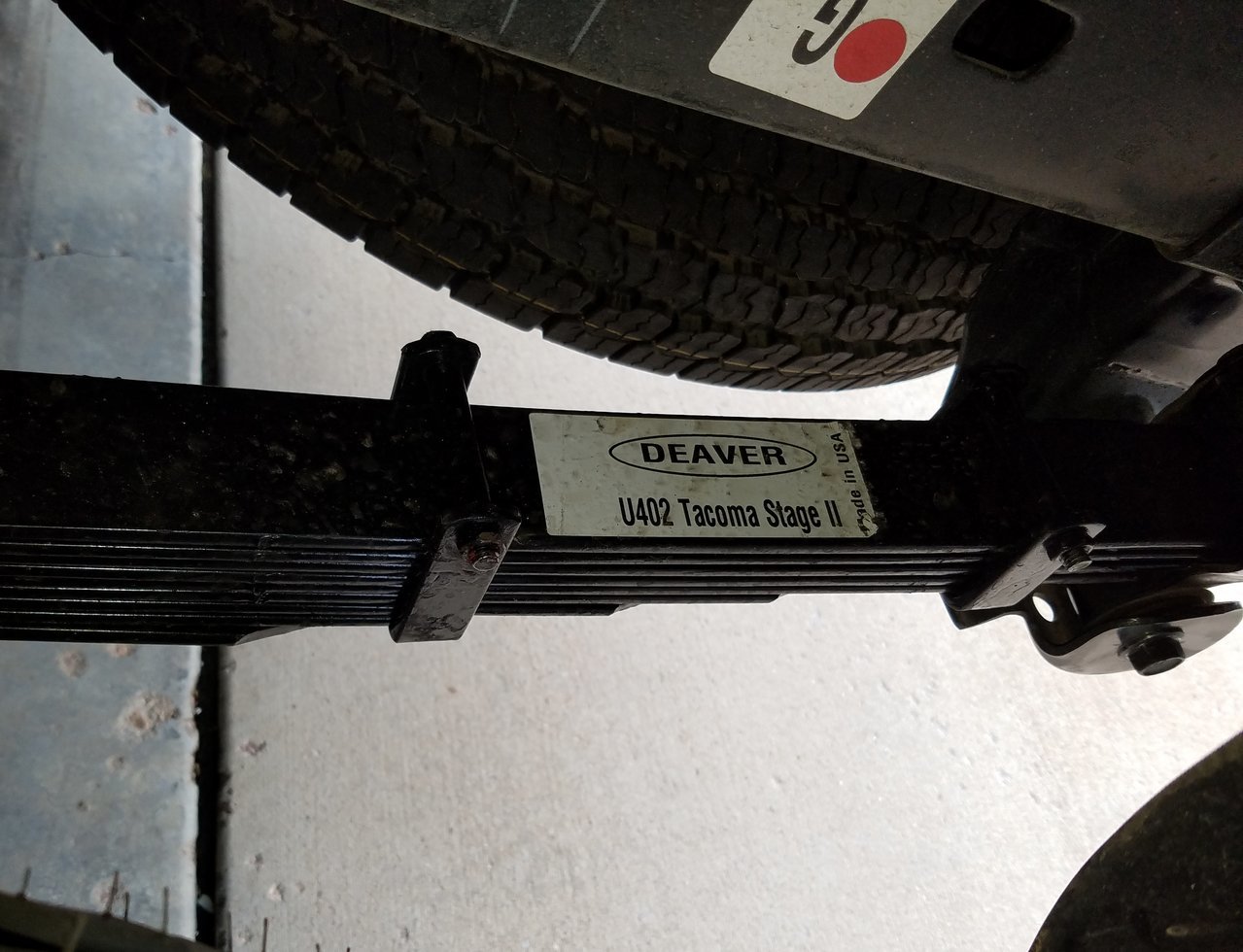

    Check Out My Build Thread :)
    Total of 10 leafs 8 top leafs and 2 over load leafs
  2. Sep 29, 2017 at 7:16 AM
    #142
    JoeCOVA
    JoeCOVA Well-Known Member
    Nov 15, 2016
    #202463
    9,655
    Joe
    Colorado Springs
    Ford F350, Lexus RX450h, FZJ80, Jeep YJ
    Yup that's right you should have the correct ones.

  3. Sep 29, 2017 at 7:22 AM
    #143
    Danactive
    Danactive [OP] Instagram: xxdanactivexx
    Apr 15, 2016
    #184403
    1,128
    Dan
    Upstate New York
    2016 MGM TRD Sport 4x4 DCSB
    thanks! i didnt want to go through all the hassle of installing them just to find out i had gotten the lower rated ones lol these things are heavy AF!

  4. Sep 29, 2017 at 7:23 AM
    #144
    Glenn_R
    Glenn_R The Unicorn Turd Gen
    Nov 8, 2016
    #201874
    1,150
    Glenn
    17 Tacoma DCSB OR Inferno
    Is there a difference between the three model of expedition leaf packs as far as leaf count and thickness goes?

  6. Sep 29, 2017 at 3:47 PM
    #146
    Danactive
    Apr 15, 2016
    #184403
    1,128
    Dan
    Upstate New York
    Great yeah the 500-700 lbs constant load is 10 leafs (8 top and 2 overload) but mine is only 2 3/4" thick measuring from the center
