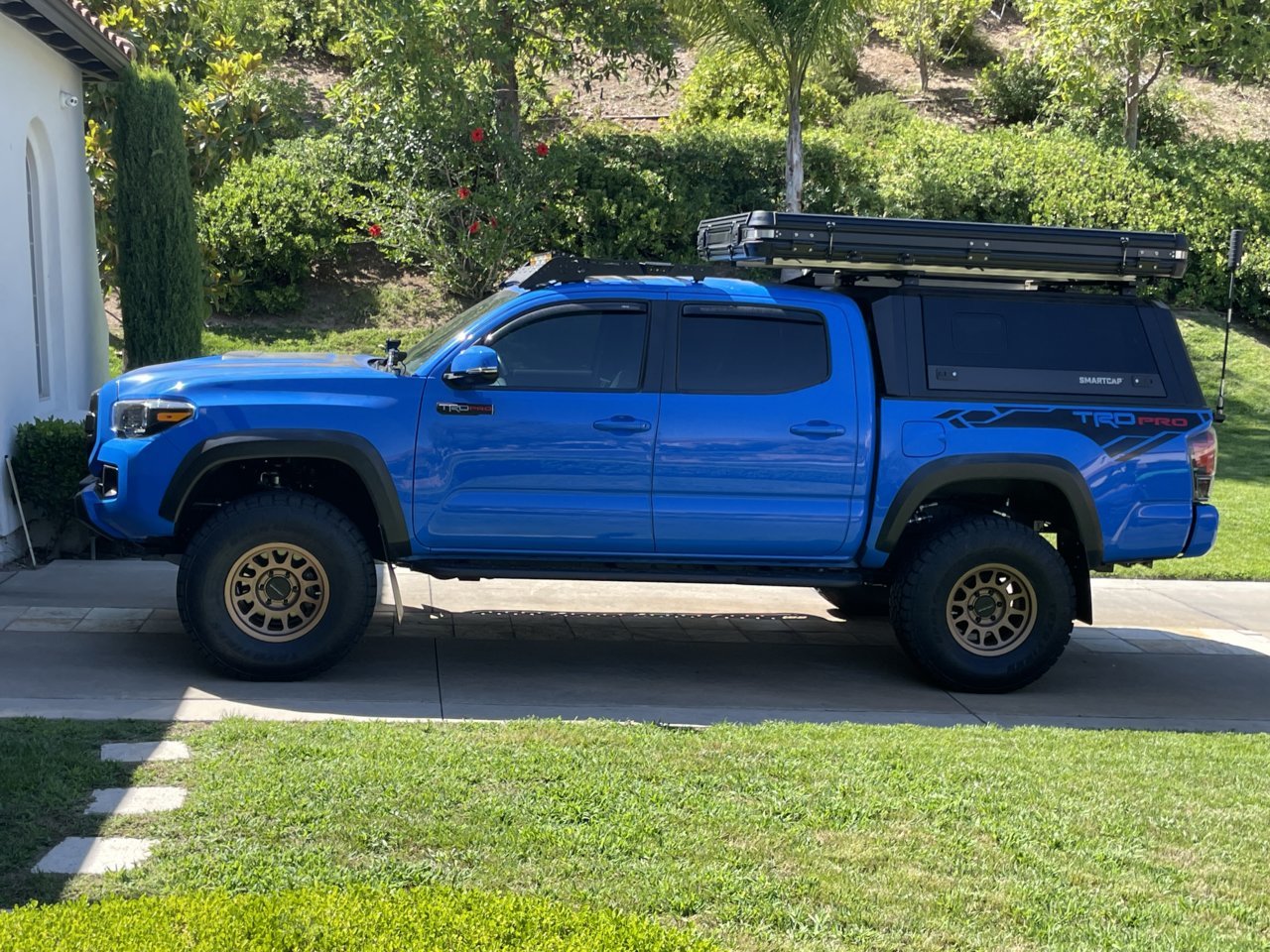

    I would think carefully about this move. I literally just sold my Deaver Stage 3s today after replacing them with Stage 2s. This was AFTER upgrading my stock TRD PROs to Accutunes Stage 4a lift kit (Fox 2.5 DSCs, 650lb coils). Even with the stage 2s, I have a slight rake despite a good deal of weight which includes: RSI Canopy, Prinsu Rack, 150lb RTT, 4 tires in my bed. My plan is to wait for my HC bumper to arrive and decide if I need to take my truck to Deaver to recalibrate the leaf packs.
    With your stock TRD Pros, you will not be happy with the amount of rake! As the previous post showed, even Stage 2s with the factory TRD Pro suspensions create a fairly aggressive rake!

    Driveway is sloped. I have 5 tires inside the canopy and a wheel. Hopefully my dual swing out bumper and spare will balance out once I remove all the weight. Otherwise, I plan on visiting Deaver.

    Appreciate your input. I know this sounds crazy.. but I can't wait to bring my rear back down with my HC bumper and additional weight.
    Previous post was with Deaver Stage 3s. What is pictured is with Stage 2s. With all that weight, I still have a slight rake.

    What rtt is that?

    Front is at 2.5, shock measures 21”. Maybe it’s because of Accutune’s Tundra shocks in the rear? ‍♂️

    Snug Top Hi-Liner
    49” Evolution
