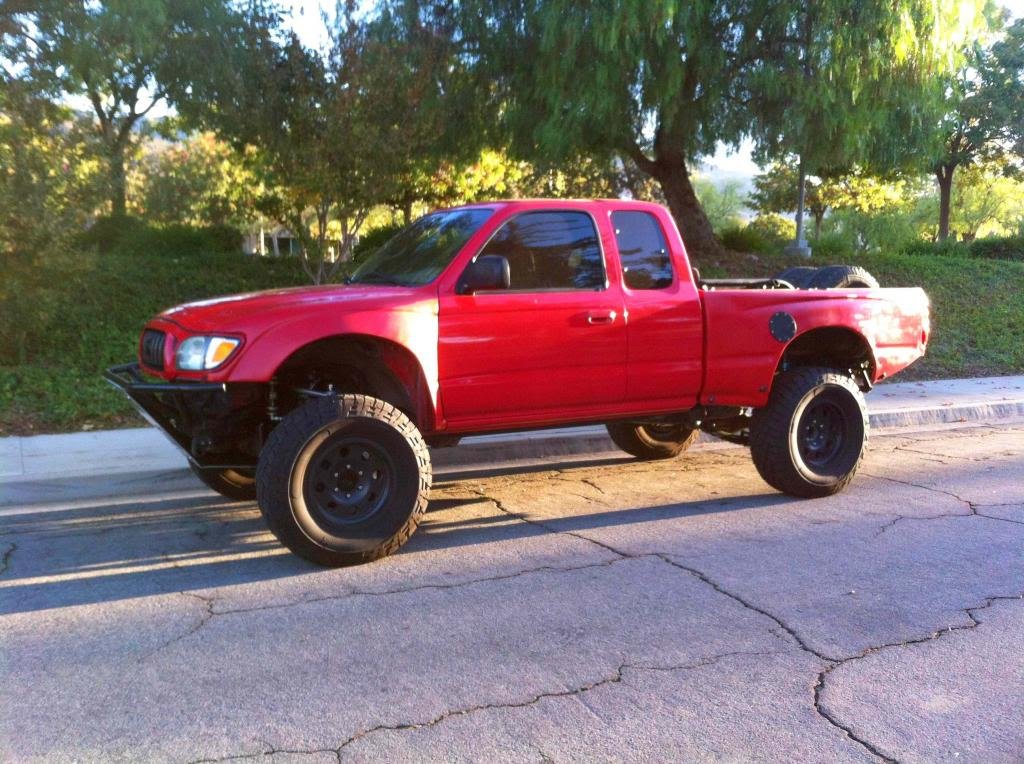

    I'm running the F67 pack on my reg cab.
    FF9EF517-0927-4332-A850-803C3DBE37E3_zps_3165a569913dfa068044f7813a114bceaf57e0af.jpg
    because_wumbo-truck likes this.

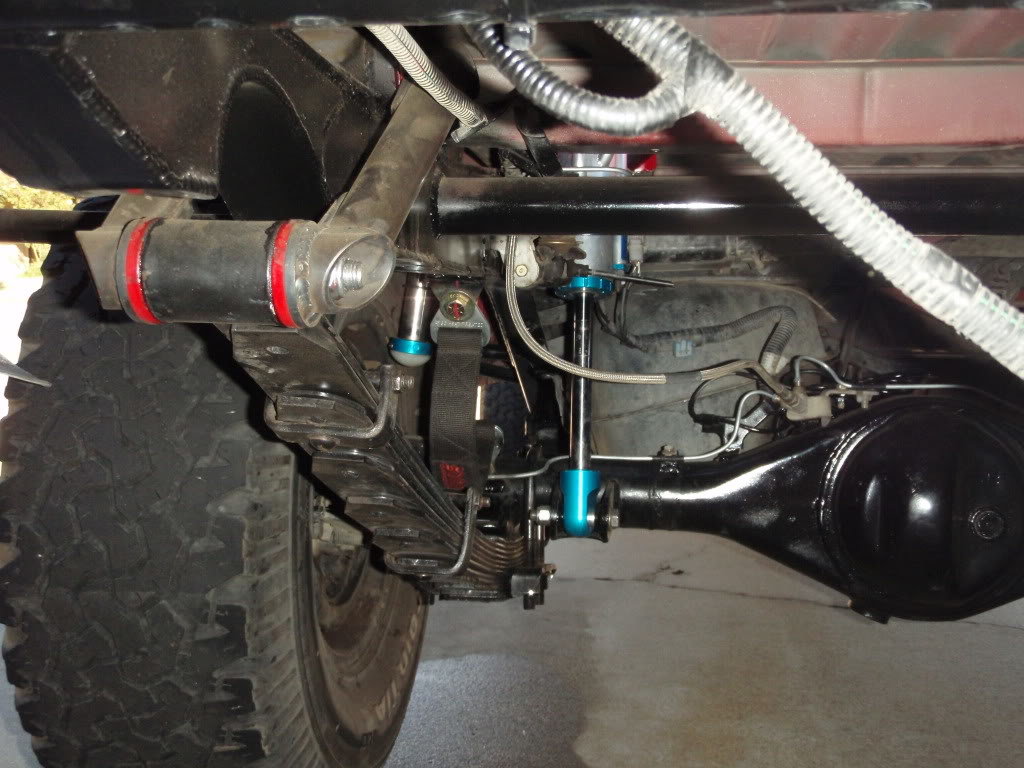

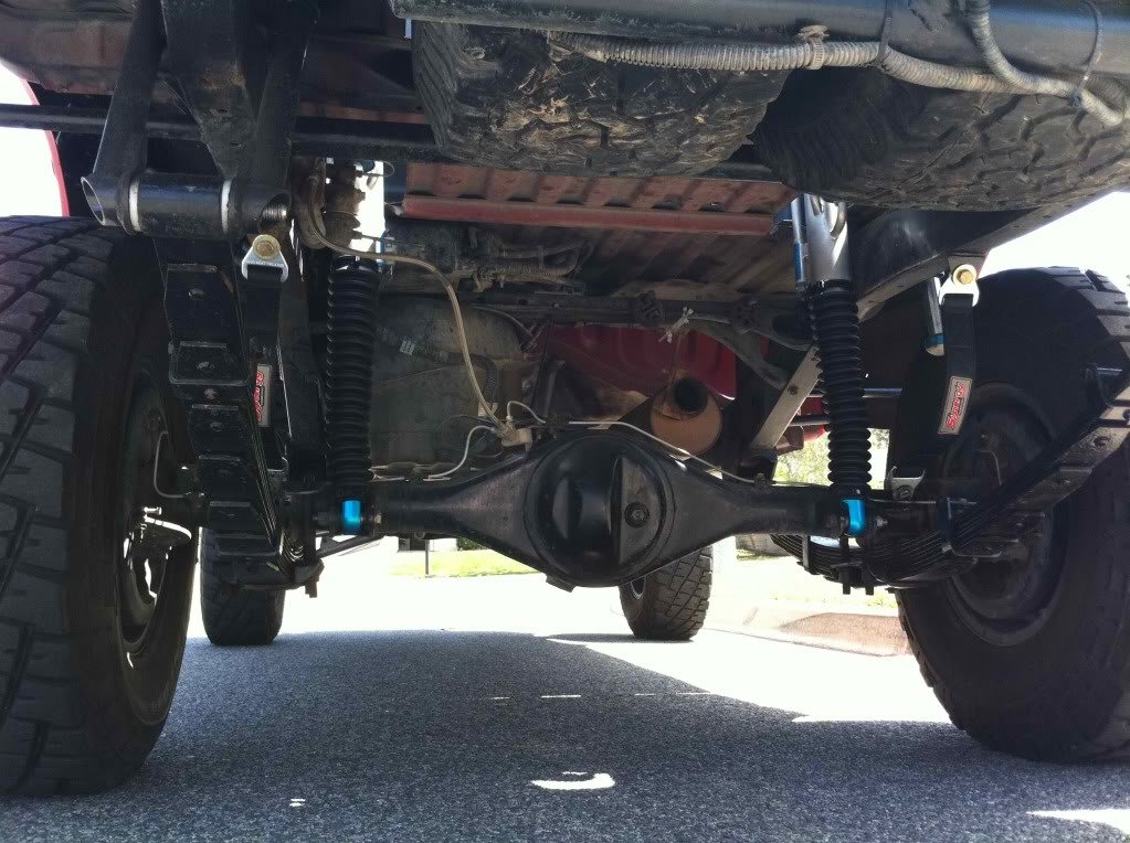

    you do not want the f55 pack. i ran a variety of different packs on my old truck and the f55 were the quickest to be replaced. they're just not a well performing pack in terms of load capacity (truck weight, spare tires, gear) and ride. they sit very flat compared to f67 or comprable packs
    f67s paired with a 12" shackle is a tried and true set up. that's where you'll want to start and then make changes from there based on your needs
    some pics for ya. let me know if you need more. great looking truck btw
    f55s with a 9" shackle above the frame
    f67s with 12" shackle
