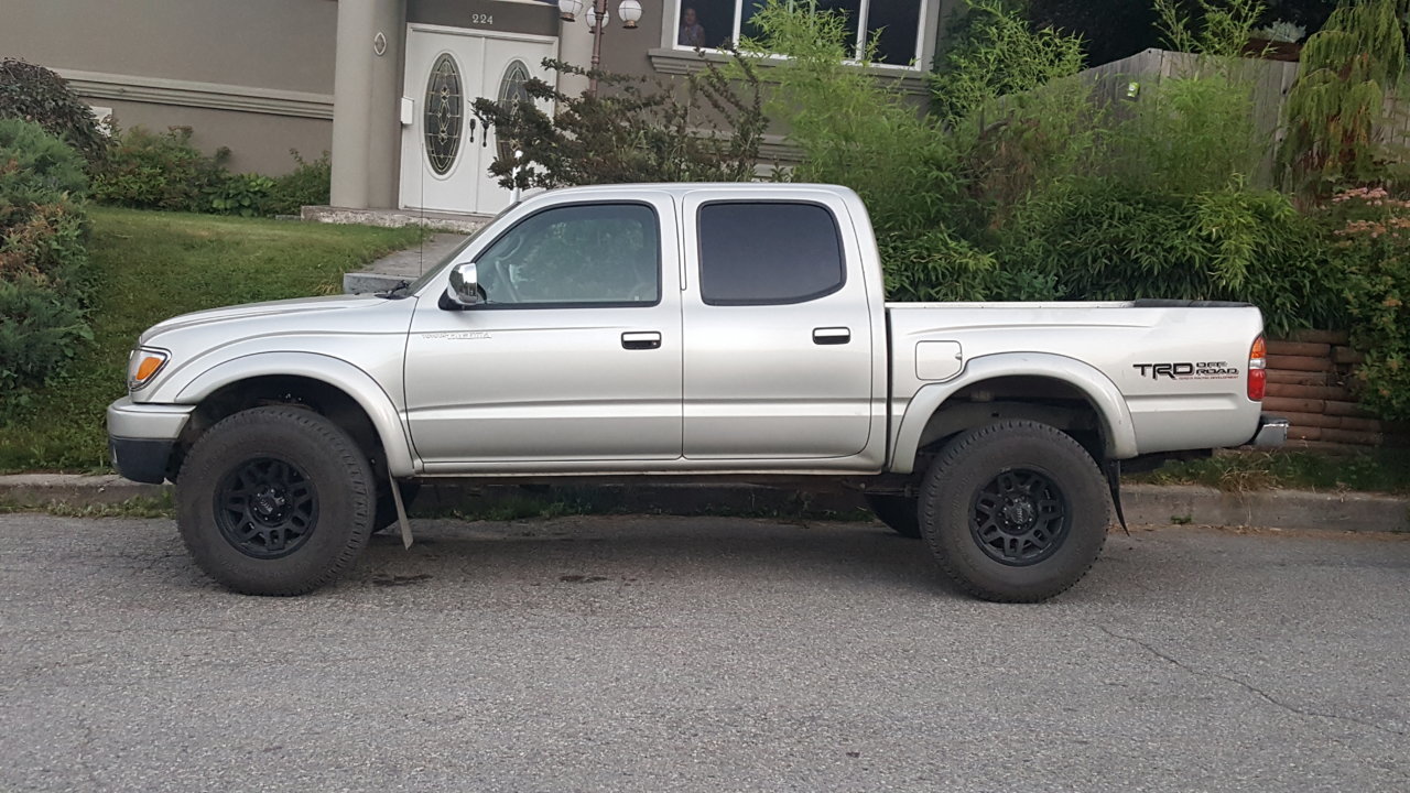

    Here's mine with fresh general HDs put on.
    In my opinion you pay up if you expect to own your truck for a looong time. If not these general HDs will give me 150k+ km's (Canadian) .
    That is more than enough for me. I tow the trailer 4/5 times a year. Rest of time is logging roads. The general HDs feel fine off-road compared to oem. I did toss on some 5100s so that may be helping the feel as well

    Wow your truck looks great, and thanks for the info on the HDs. What size tires are those?
    I agree with your point, I'm thinking I'll bite the bullet and go Deaver.

    Thank you. They are 265 75 16. Liitpe bit of rubbing.
