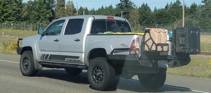

    I had about an inch of lift in the front with adjustable coils, but after a winch and bumper it was back down to stock height. When loaded with my camper though, it seems about perfectly level, so I've left it as is. Obviously I have some serious rake going on when not running heavy. You can see in the first pic below I have about 130 lbs on my swingout, with another 200lbs or so in the bed.
    This 2nd image is without the swingout completely, but I did throw 80 lbs of water against the tailgate. The Deavers just ride so much better than most HD leaf packs that it doesn't feel surprisingly rough when unloaded. I've heard it's due to the higher count of thinner leaves for a more gradual spring rate.
    One last thing to think of if going Deaver, you should probably upgrade your rear shocks. The stock shocks will act as limit straps for your rear suspensin, as the Deaver's would give more droop. HOWEVER, if you aren't offroading your truck with a wheel or two regularly off the ground, it's probably a non issue, as you'd seldom be hitting full droop hard enough to harm the shocks.
