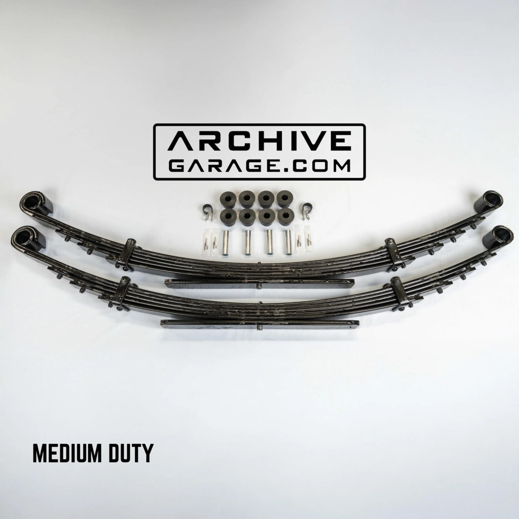

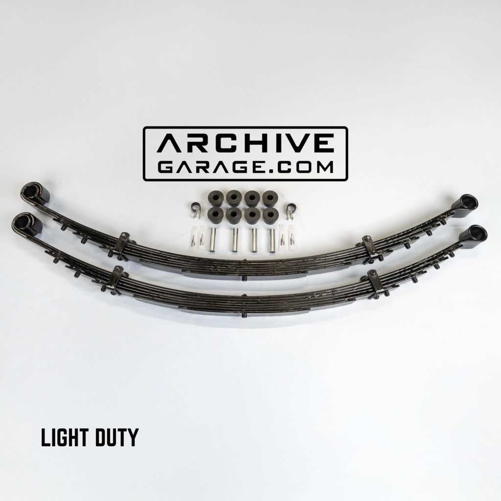

    When I click on MD on Archive’s website, it shows an overload leaf but when I select LD, there is no overload leaf in the leaf pack.

    Ya I believe they came out with it a couple months ago. The archive LD seem to be more like the N98 since they are aomits identical for amount of lift & no added bed weight. I think the N98 are thicker and made of more leafs than the archive LD.
    I have no clue which one to get. I don’t think I couldn’t go wrong with either, but I assume if one offers slightly better ride quality but that would indicate less payload capacity when occasionally carrying weight in the rear. Also, if one is slightly softer, does that mean it will sag faster over time? I have too many questions and have been researching them for about a week. Hard to find reviews on the archive LD since they’re somewhat new. There’s a decent amount of info on the J66 but not on the N98.
